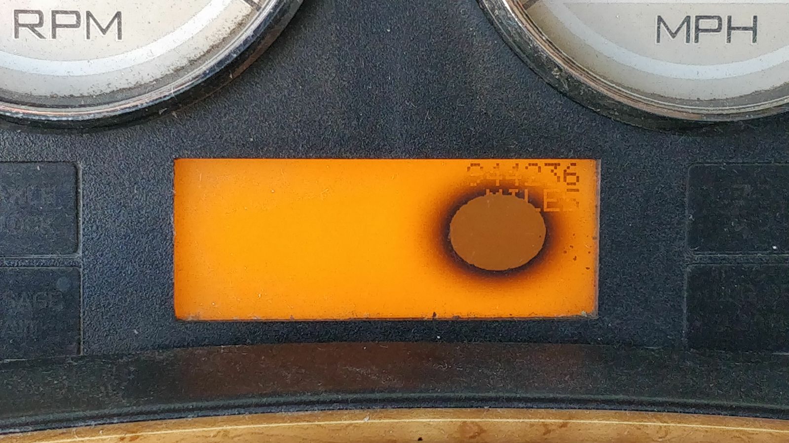

I am going to start by doing that. Should I also replace the gauge cluster? Its kind of weird that I am getting cluster communications problems and that defect that looks like a cigarette burn. If I do end up replacing the cluster gauge is there anything programing wise i have to do? or is it just plug and play?

Take a photo of it and post it. Any of your gauges not working?
10-08-2017, (Subject: Help needed )
RE: Help needed
Here is the picture of the cluster. It just started showing yesterday. all the gauges work.

(10-08-2017 )INTERPRO Wrote:  Here is the picture of the cluster. It just started showing yesterday. all the gauges work.
A prostar,.. a burned out gauge cluster and acting up cab controller,,.. There is a well known culprit,... EVERY SINGLE PROSTAR has these problems if this culprit is not fixed that I mentioned here ...
http://rawze.com/forums/showthread.php?t...2#pid16882
