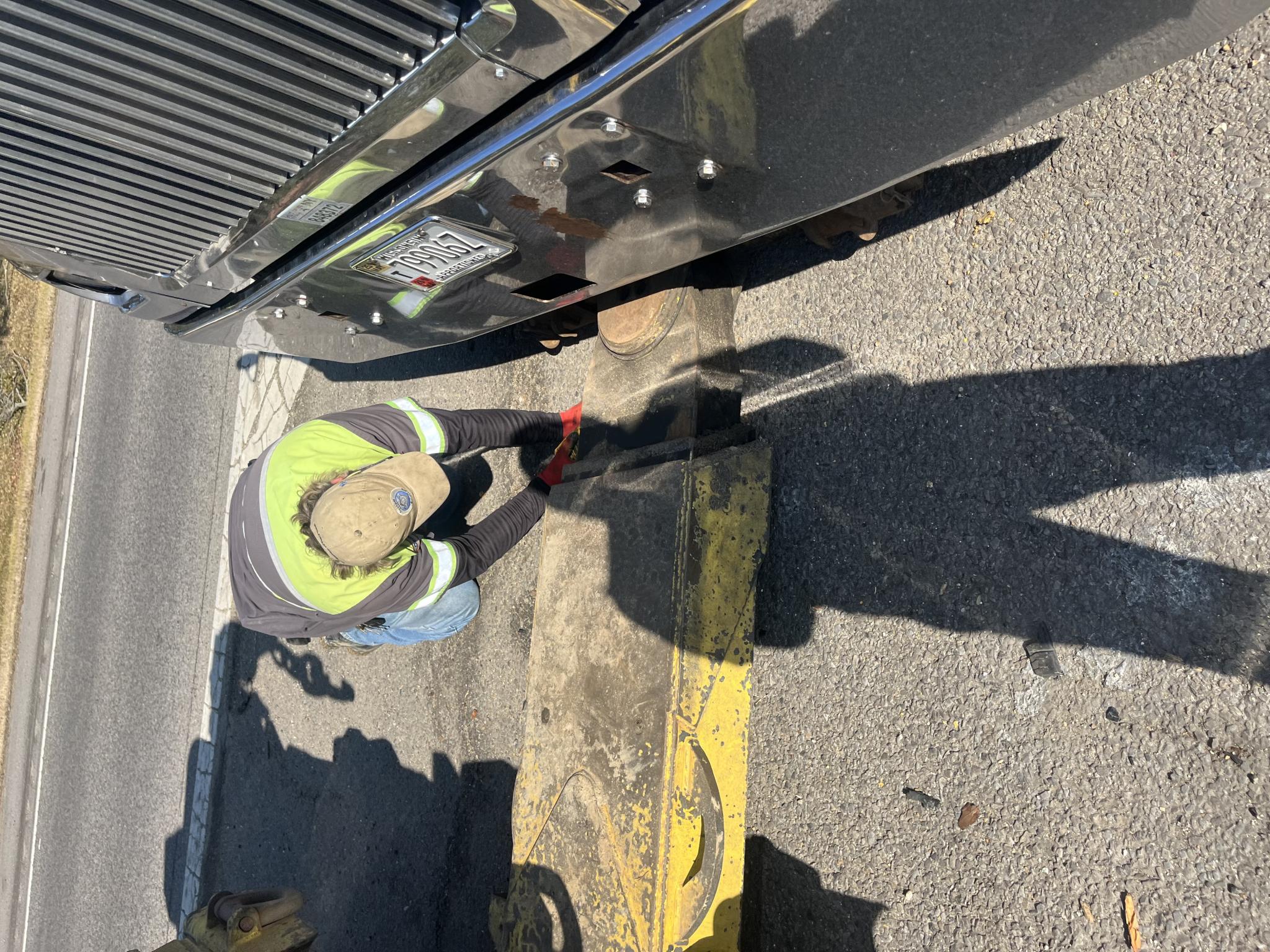

| Today, (Subject: Cm870 ) Post: #14 | |||
| RE: Cm870 Didnt get to do all that had to have it towed off the interstate. Got it into a shop, diagnosing starts on Monday they said. Another thing to add when I changed the fuse and cranked it for the third time; it stopped to turned over at a full rotation. It just did like a one bump then you could hear the starter tapping sound. Don’t know what’s that all about. | |||
