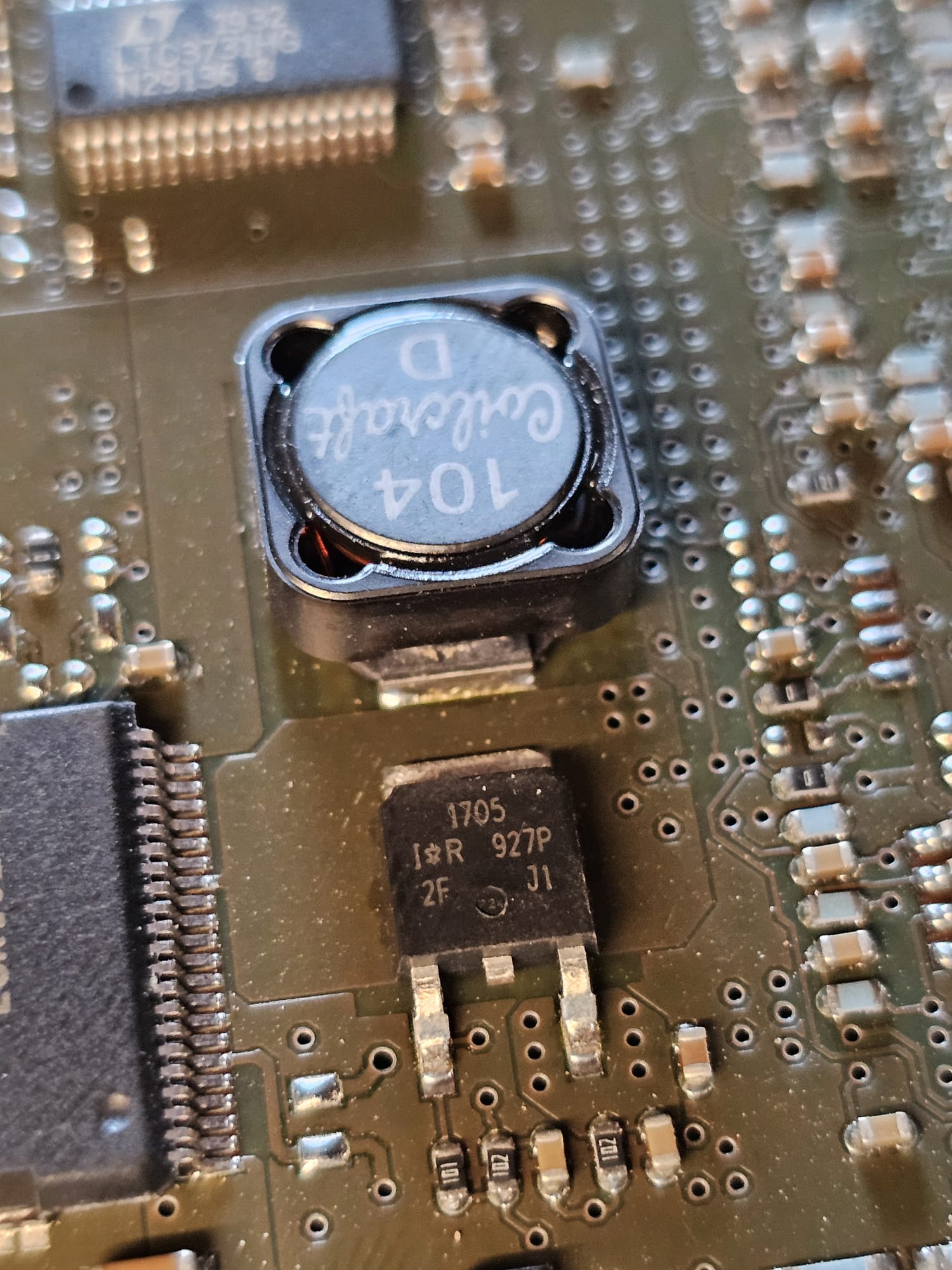

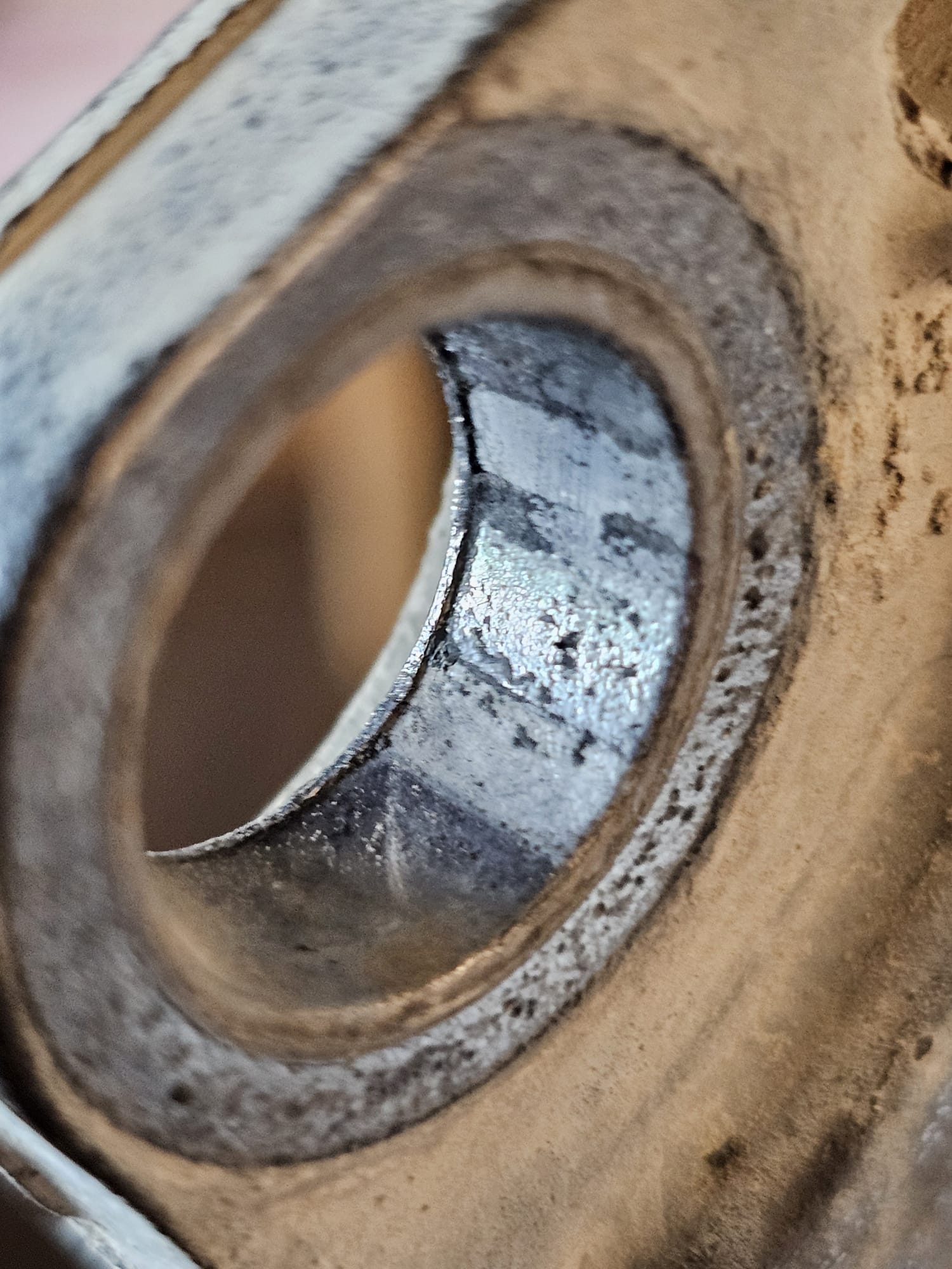

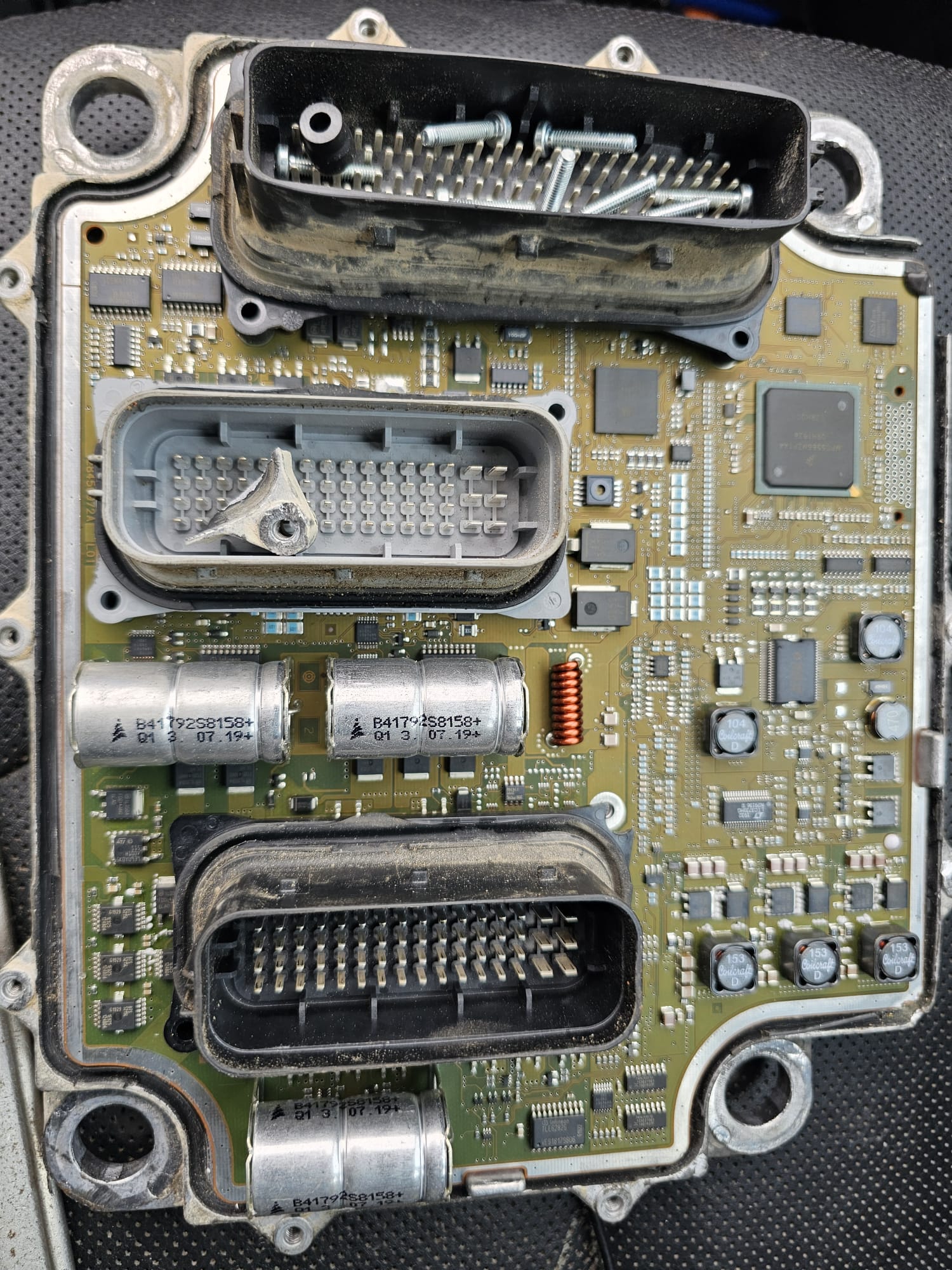

| 07-21-2026, (Subject: 2021 MX13 pac car dpf and scr efficiency issues in need of egr tuneup ) Post: #27 | |||
