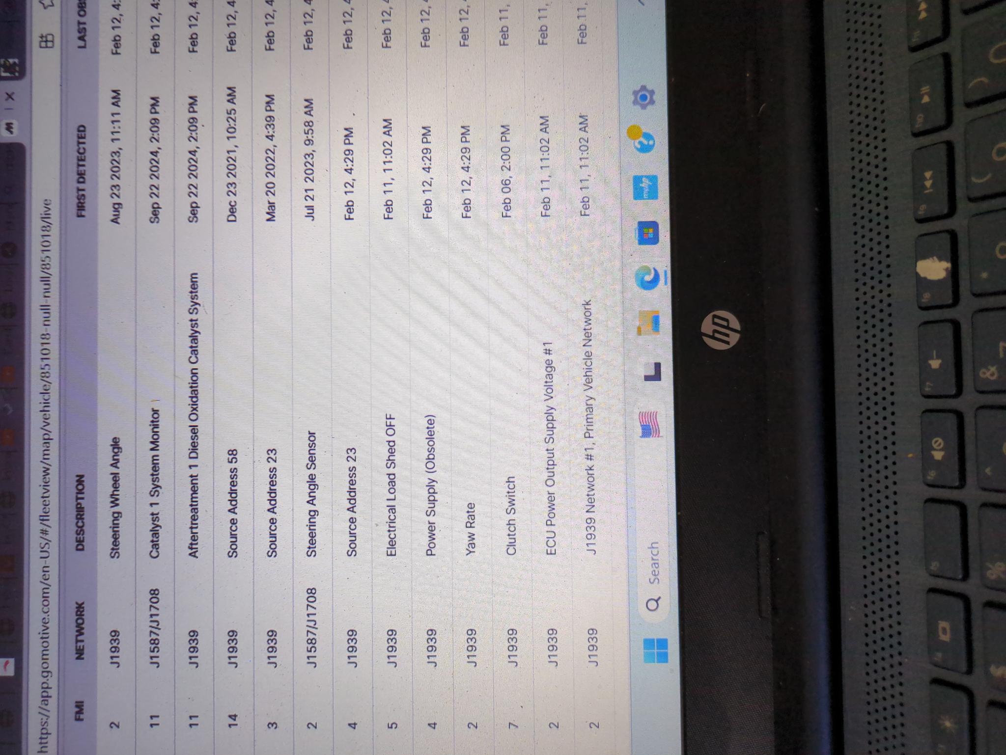

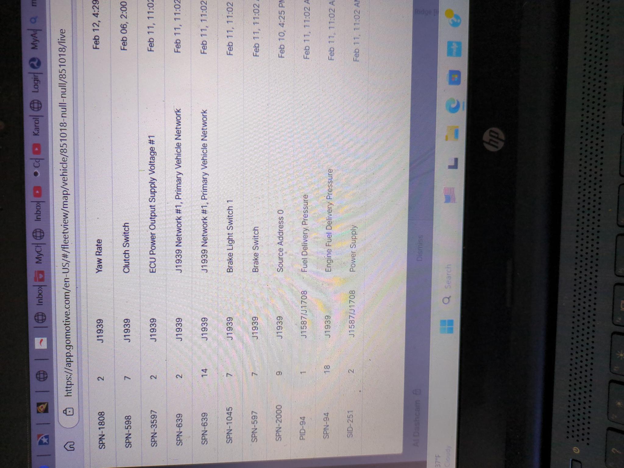

I'm going to attempt to attach a laundry list of 20 codes the truck just threw over a two day 150MILE trip last week and Hopefully see what your opinion is. Thanks again,Robert

Ok, I'm going to try posting a screenshot of the laundry list here now.
02-17-2025, (Subject: Random shut down )
RE: Random shut down
More...
