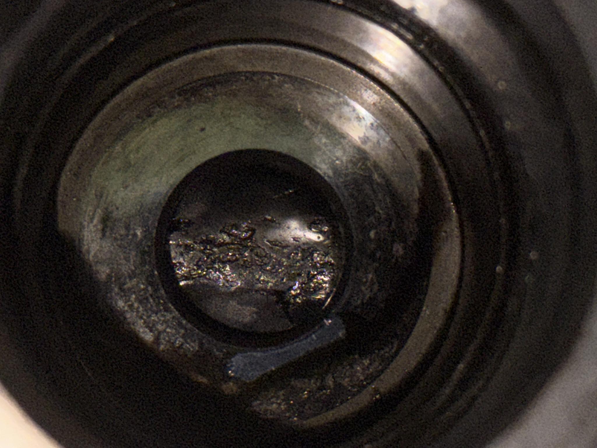

| 01-23-2025, (Subject: CM2350 X101 ) Post: #5 | |||
RE: CM2350 X101 (01-23-2025 )Ravenwood Wrote: So here’s the update on my situation. 1st I really want to thank you Rawze for pointing me in the right direction. Went to replace the top end of my fuel pump and this is what I found. that failure can destroy the entire engine if it has been driven like that for any length of time. you need to make sure your front gear train is not pitted all up. you also need to drop a main bearing and see if it is scarred up too. User's Signature: ->: What I post is just my own thoughts and Opinions! --- I AM Full Of S__T!. | |||
