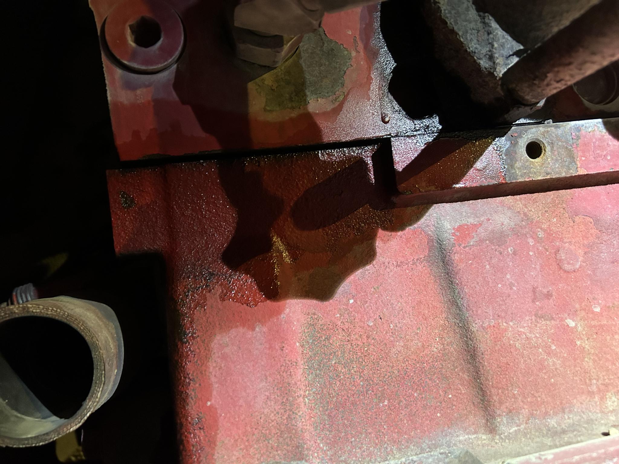

| 870 leaks fluid from exhaust manifold What could be causing the leak? | |||
| 11-30-2023, (Subject: 870 leaks fluid from exhaust manifold ) Post: #2 | |||
| RE: 870 leaks fluid from exhaust manifold Could be valve guide seals, piston rings, scored liner, leaking injector, leaking injector cup? | |||

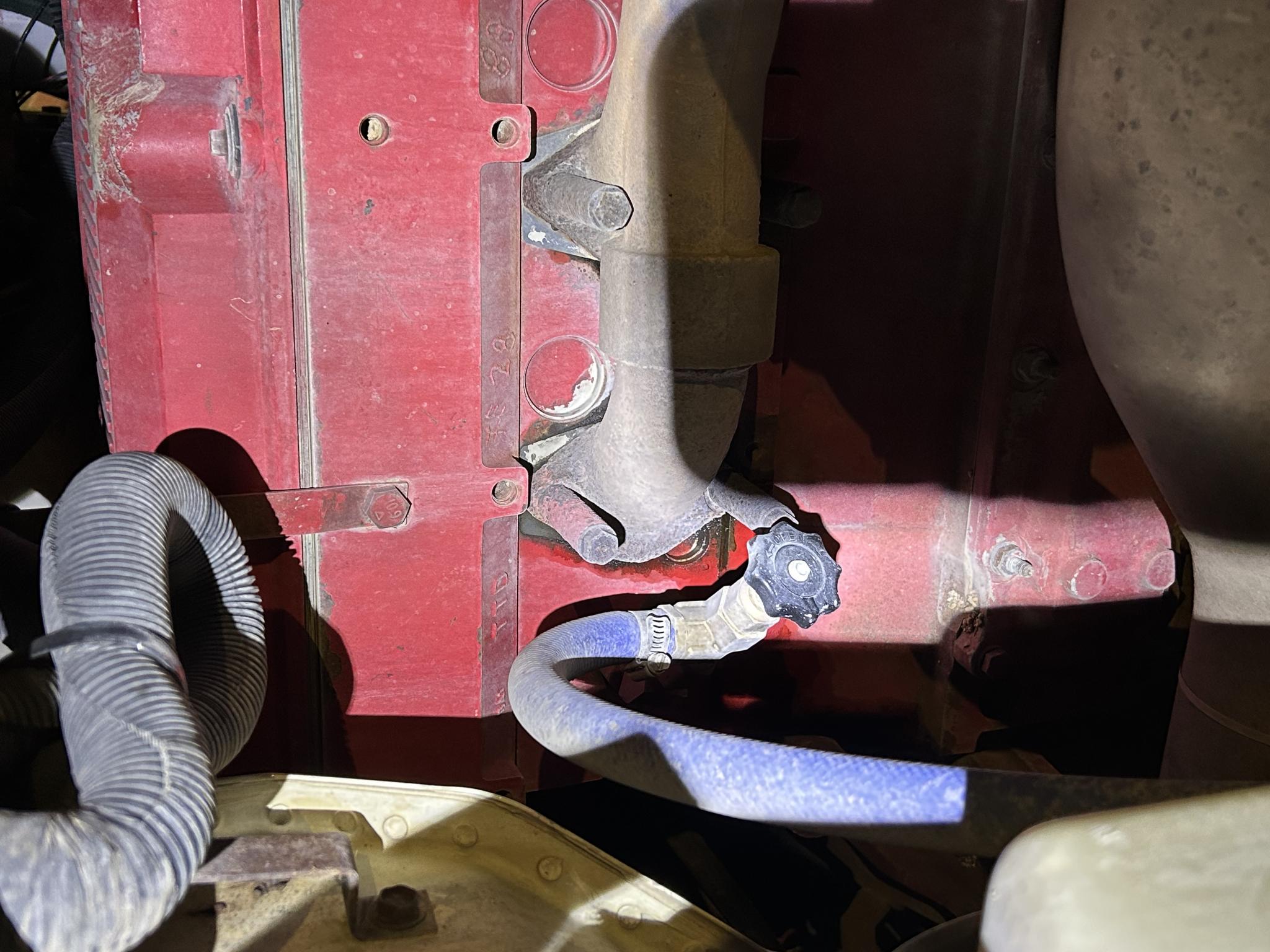

| RE: 870 leaks fluid from exhaust manifold Another pic | |||

| RE: 870 leaks fluid from exhaust manifold Looks to me anyways .. mostly like oil from leaky valve guide seal(s) that is sneaking past the manifold gasket. Valve guide seal seepage is not too uncommon on a head that is getting old and wearing out. User's Signature: ->: What I post is just my own thoughts and Opinions! --- I AM Full Of S__T!. | |||
