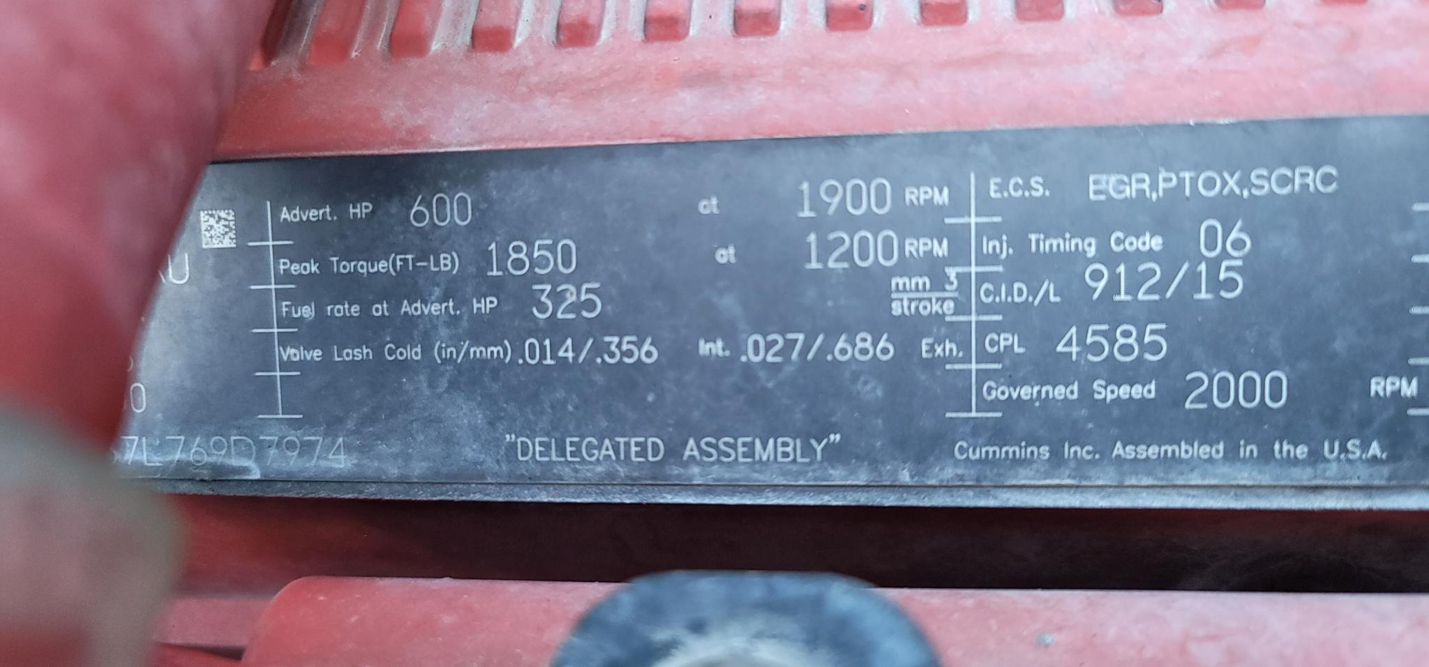

| Owner operator here. Almost two years ago I bought a low mileage (180k) Kenworth with a 2015 ISX 600. It was a single owner southern truck that had not once seen the snow and had just crossed the threshold of being under any kind of factory warranty. It's a beautiful truck and I got a great deal on it due to the age and therefore lack of warranty. I had one obvious plan in mind. The truck was a perfect candidate for "weight loss" surgery. I hated the idea of choking the motor with exhaust and being a W900; sounding like a pick-up truck. I of course spent money (twice actually) to help in this regard and it has served me and my family well for the past nearly 200k miles. Until recently. I've always known something wasn't quite right because with both the different shop "tunes", my truck sounds like a fighter jet about to take off when idling. The boost sits around 1.5 PSI. I am also lucky to see 5+ mpg loaded or 6 mpg empty; although it was not much better before surgery. So I lost what fuel economy I did have and if anything; as well as some performance. It is built for 100k+ hauling and has a 3:73 rear end with 600 factory hp, so it has plenty of power. Fuel economy isn't exactly its purpose . A month ago the EGR cooler up pipe snapped near the cooler, so I replaced it. The next load out, the boot connected to it split. I replaced it. I've noticed over the past few weeks that my oil temperature is getting awfully close to the 250 f mark. I run full synthetic so I'm not concerned about oil damage. This month I've run an overhead and performed a cylinder test via Cummings Insite trying to track down a vibration or "ruff" idle. I used the Rawze method of idling the motor with a single cylinder and repeating for all six. All cylinders “fire” and sound similar. I have a new dampener, IMAP, oil temp, and oil pressure sensors waiting at the house to install on my next home time. What is my next theoretical step? Obtain CT and adjust variables based on recommendations? Who's? ISX15 parameters? The old "If you want it done right..." saying is truer more now than ever these days and I am running low on money and options in the current “climate”. Originally I thought "let the guys who do it everyday take care of it". How naïve of me. | |||

| RE: ISX 600: Trouble in paradise I Was sent the file from this persons truck today. Here is what I see at a glance... * No proper engine mode control was done. This causes the engine to try to warm up the DPF, SRC, ETC... perpetually, because it can never satisfy this condition, it using the turbo to choke the the exhaust + creating excessive internal friction on the cylinders all the time... shortening the engine life and creating excess friction by a lot. - Results are typically higher than normal oil temps.. lower then normal fuel mileage, over-boosting turbo, etc.etc.etc. * Protection fuel limiters are still in place. The engine is not able to make full power/torque. * DPF Restriction test not shut off properly. * Excess Soot derate protection not shut off properly + Shutdown Protection for excess soot is still in place. The engine is still able to unpredictably shut down over this at some point in its future. * Engine is still assuming+requesting EGR gas is going into the intake. The engine will have the wrong fuel-air-mix, too far advanced injection timing, etc. This is harmful / shortens engine life. * injection timing is set too high and moderately harmful to the engine. Can cause a piston to crack / shortens engine life. * The fuel-air-mix is set too lean and is harmful to a deleted engine. * the turbo has been set waay to high for a W900. Will over-spool and over-boost the engine causing damage to the cylinders. Can cause crack in head, crack in piston, is harmful, causes too much friction in engine+ higher then normal oil temps. * engine brake was screwed with. This is an absolute NO-NO!... and can cause the engine to drop a valve at HIGH RPM and high Engine brake conditions. * ALL EACD fall-back emissions control is still active. This will cause unstable power, cause injection timning and other things to be screweed with in attempts of conform to fall-back emissions standards. * Alpha settings are incomplete. The engine is jumping into protections and derating at times. * sensors not shut off properly for... -= Just bad, incomplete programming on someone's part ... -DPF inlet temp. not shut off properly. -DPF outlet temp. not shut off properly. -DPF outlet Pressure not shut off properly. -DPF Delta-P. not shut off properly. -DPF outlet pressure. not shut off properly. -Doser injector not shut off properly. -SCR inlet temp. not shut off properly. -SCR outlet temp. not shut off properly. -DEF pump not shut off properly. -DEF Tank Level not shut off properly. -DEF Tank Temp not shut off properly. -DEF Tank Heater/Line heater not shut off properly. -DOC inlet temp. not shut off properly. -DOC outlet temp. not shut off properly. -CCP sensor not shut off properly. -IAT not shut off properly. =============== - It looks to be the typical hack-n-slash where someone disconnects things and assumes the ECM has magical fairy dust inside itself to fix everything for them. Its terrible and moderately harmful to the engine. This person will be lucky if they do not need an inframe within the next year or so, especially if this thing has been run hard, after running it for 2+ years with this horrible, engine-eating program for so long. Welcome to the bad delete collection. You are today's official winner. ref: http://rawze.com/forums/showthread.php?t...5#pid13255 truly sad indeed. User's Signature: ->: What I post is just my own thoughts and Opinions! --- I AM Full Of S__T!. | |||
