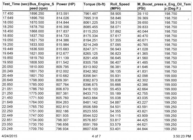

Remember, this truck has nearly half a million miles on it.. and was 100% stock hardware (minus the egr of course). Here is page 4 of 7 where it reached max torque and HP (I have the entire report)...

With MM in it, the final results were ...
Final HP at the flywheel (maximum) : 965.04 HP
Final HP at the tires (maximum) : 817.83 HP @ 1800 RPM in TOP gear
Oil Temp at maximum engine output: (it settled in at about 231 -F )
EGT at maximum engine output: 910 -F
* Excess engine vibration -- NONE
The guys at the dyno, the owner of the truck, and everyone there's knees buckled in disbelief at the difference!...
They did play with boost a bit to try to optimize it, but just like i say to everyone,... they found that 38~ish PSI was the sweet spot for max HP output. They tried to make it go above 39 or so, but it started to fall off again and create exhaust restriction. This falls right in place with my own results a few years ago when I did some competition engines for some Aussie guys back in the MM 1 days.
--= (CM871): 37-38 PSI at 600HP is the absolute max that anyone should ever see if they want to keep from shortening engine life.
Not only was the power right on que with the programming, but notice how much COOLER the engine is running with that much power output. Also there was no more engine vibration, indicating that it clearly could go higher without destruction. This clearly proves beyond ANY shadow of ANY doubt, that M-M-2 is the ONLY WAY to program this motor right, especially if you are going to do high output engine competitions with it.
Since the engine was running cool as a cucumber, and was not producing any excess cylinder pressures, had no excess vibration, and appeared to handle it nicely, the truck owner was asked if he wanted it higher. He said no, because it was an engine with 450k miles on it already, and they did not want to push it harder. -- i don't blame him. An ISX built for that much power etc. needs to have the head hand-torqued, etc. to be reliable.

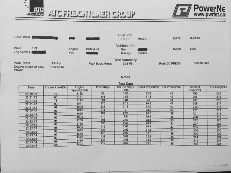

./uploads/201609/post_1749_1472974174_00788143cb35806292a00ea764969797.jpeg
Got mine dynoed before it hit the road few days ago,
It has 524 hp tune with 650k miles and had broken plungers flushed out the ceramic from oil,
Was hoping to get 400hp the wheels it did much better than 80% to the wheels,
Truck just made it back from 4500 mile trip thru the rockies.
Cant be happier with rawzes ecu tune and great engine tune up by mr hagg

@Rawze
Is the crank case pressure reading normal on my dyno?
