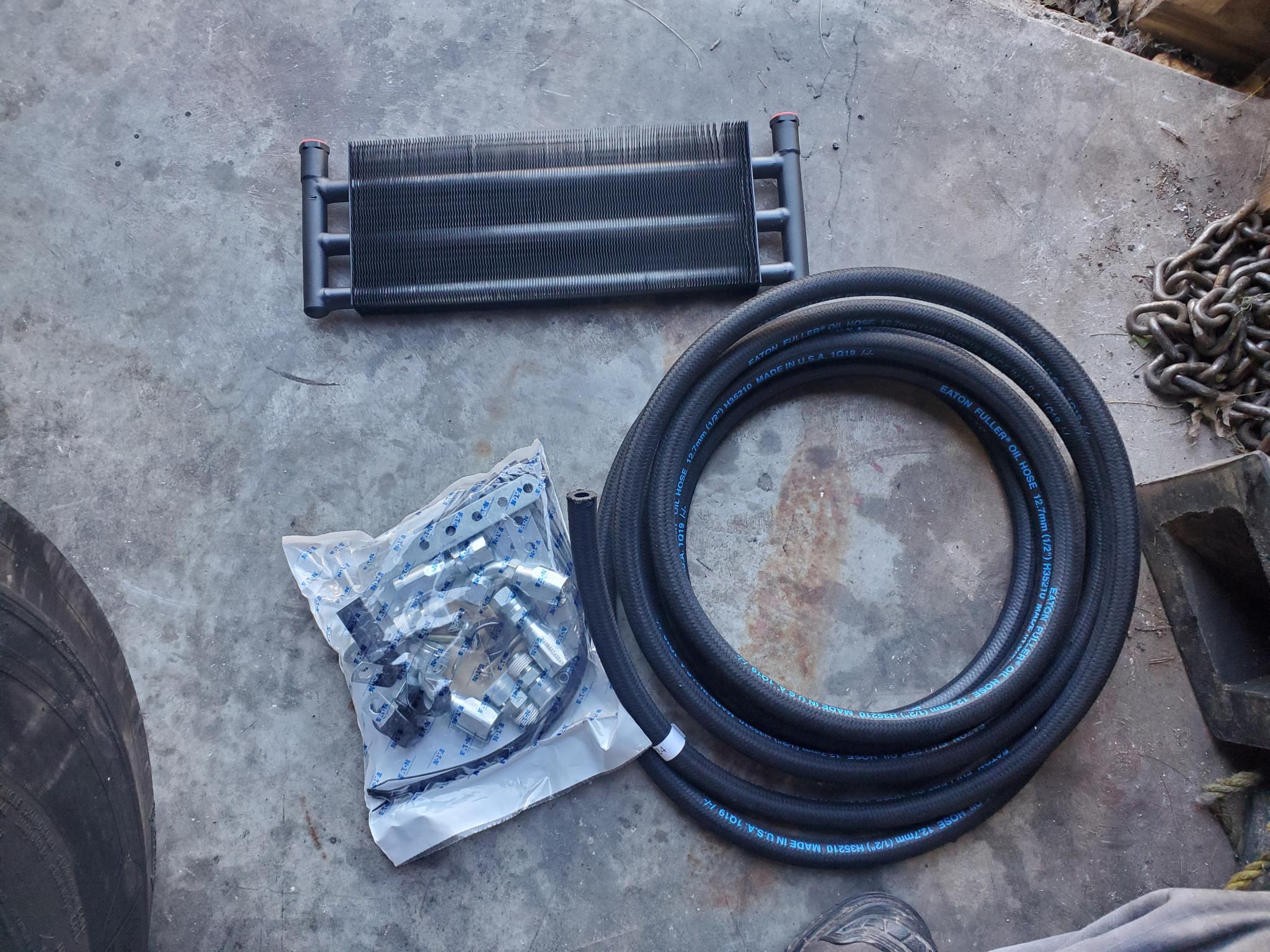

| RE: KW T660 transmission oil cooler from coolant to air Mr. Hagg neglected to mention the K-1956 is the most complete kit you can buy. It comes with everything including steel braided hydraulic line and screw on fittings (not crimp) Wow, did that make life a bit easier today. KW wanted $770 for it I got it at fleetpride for $650 which seems the going rate before shipping at online vendors. | |||

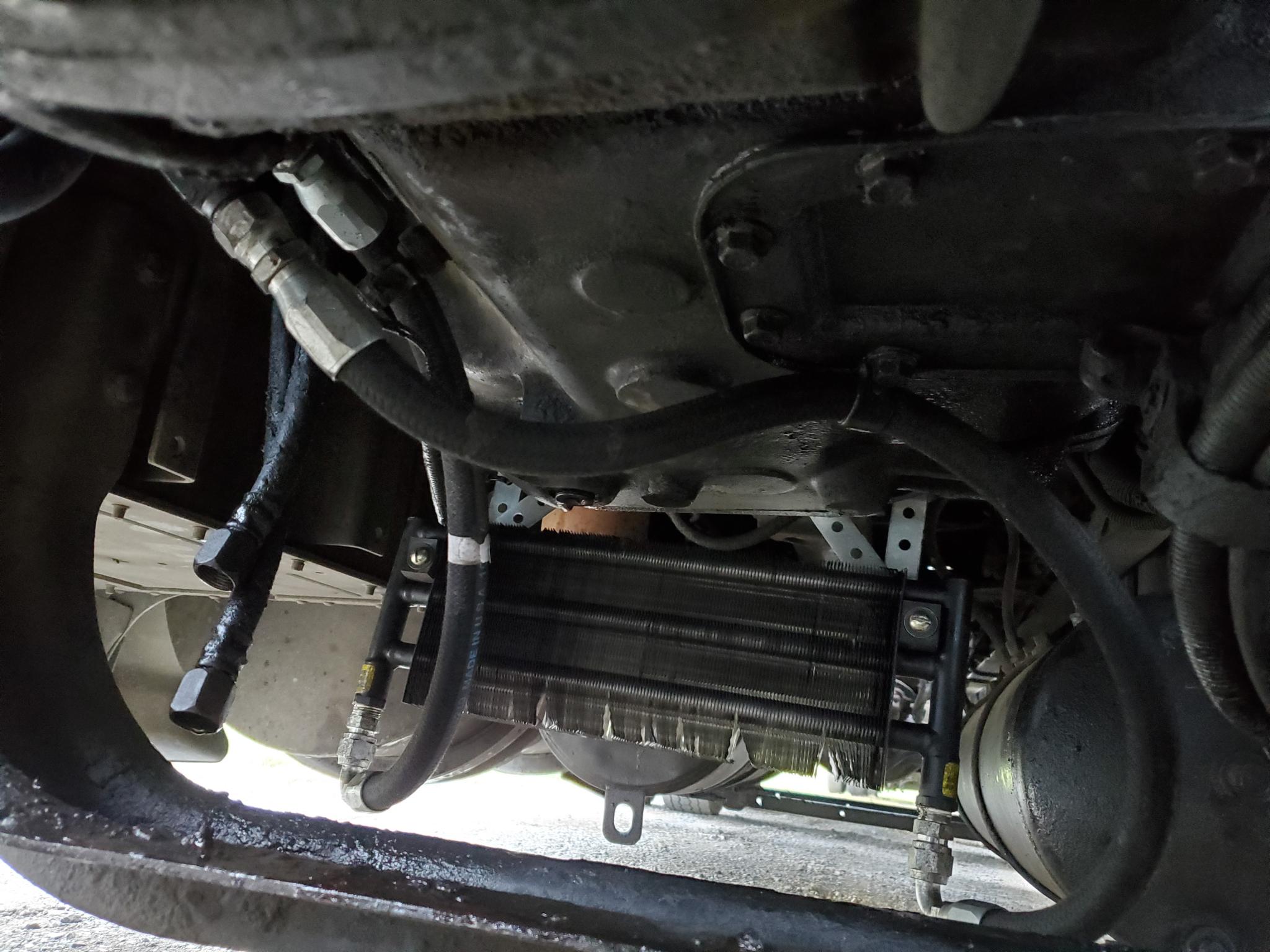

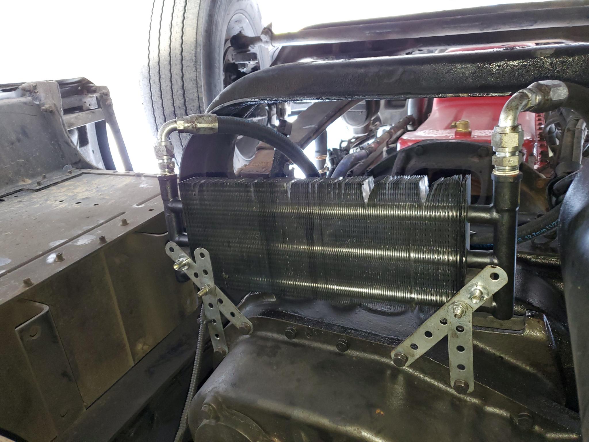

| RE: KW T660 transmission oil cooler from coolant to air I crawled under and snapped a couple shots. The hangers that come with the kit are pretty flimsy so I doubled them up. After installing the lines and a hose clamp it was fairly solid. I chose the back of the transmission as the mounting spot because thats exactly where they were for the longest time in the 90's and 2000's. I imagine they started putting them up front in front of the radiator when manufacturers started cramming thing in tighter and more stuff under the truck. But on this t660 there was plenty of room for it there. I also never liked having 20 or more feet of hose running up to the front of the truck and back. Less spots for it to fail this way. Also Mr. Hagg's suggestion to use diesel to flush the transmission worked fairly well. I put a gallon or so in the case and fired the truck off for 30 or so seconds then drained and blew out the transmission. Then I filled it with cheap gear lube and ran a short run (200 miles) and then came back and drained that stuff to make sure I got most if the contamination out. Then filled with synthetic 75w90. I did another short run today (250 miles) and the temp gauge never moved off 150°. Where as before with the coolant circulation it kept it consistently at engine operating temps. I'm pleased with the whole process. And if those hangers fail I can simply fabricate sturdier brackets out of scrap steel or aluminum. | |||
