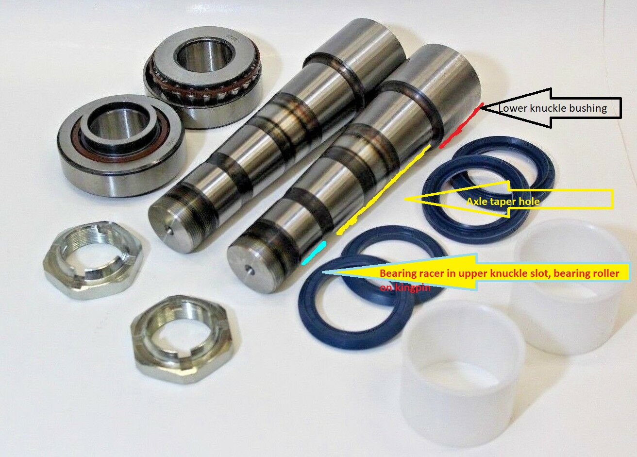

| Kingpin settings Have difficulties to understand clearly how to change kingpins. Manual says to torque 200 ft-pound and check is knuckle turns freely then torque to 600 ft-pound. I understand that 600 need to drive king pin all the way inside the tapper hole in axle but bearing is locked with such high clamping force. What is missed in manual or something I just got wrong. STEMCO M536M. | |||
