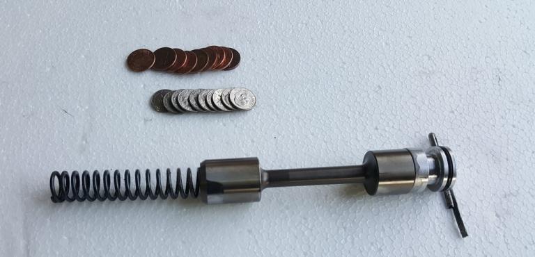

| Oil pump shim I remember from the old site that you can use dimes or pennies to shim the oil pump but how many do you need to to use? My engine is getting a new head and rod and main bearings and want to up the oil preasure wile everything is apart so how many and wich one do I need to use? | |||

| RE: Oil pump shim Dimes or pennies? Inflation !!!!! Quarters!!!! If i remember it right four. | |||

RE: Oil pump shim ![]() ![]() (04-05-2016 )Erics diesel Wrote: I remember from the old site that you can use dimes or pennies to shim the oil pump but how many do you need to to use? My engine is getting a new head and rod and main bearings and want to up the oil preasure wile everything is apart so how many and wich one do I need to use? Take a look,then check your hardware (spring and plunger for wear.There is a replacement kit available which I posted the number. User's Signature: 36-25-34 | |||

| RE: Oil pump shim gearhead has the exact shim measurement - but its more than you think - i believe his was somewhere in the 1/2" range but im sure he will chime in to make sure. | |||

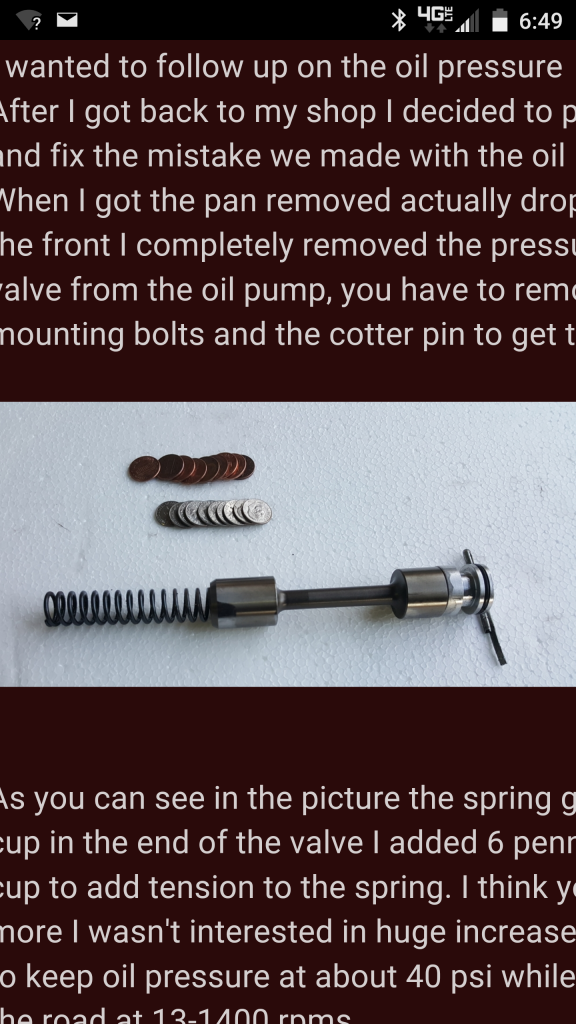

RE: Oil pump shim (09-15-2015 )Gadget Wrote: I wanted to follow up on the oil pressure User's Signature: ->: What I post is just my own thoughts and Opinions! --- I AM Full Of S__T!. | |||

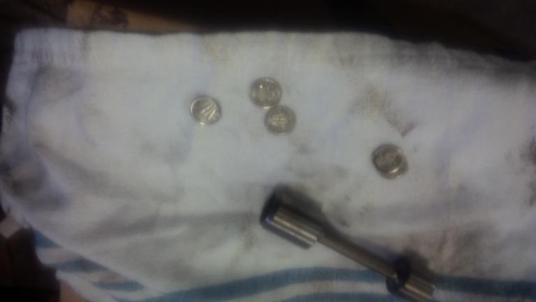

| RE: Oil pump shim I will use 8 pennies and let you guys know what the preasure is like once we get it back on the road hopefully this weekend | |||

| RE: Oil pump shim I will be shimming mine a bit too, but ... I would suspect that the more you shimm it, the shorter its lifespan will be as well.- Just some thoughts. User's Signature: ->: What I post is just my own thoughts and Opinions! --- I AM Full Of S__T!. | |||
