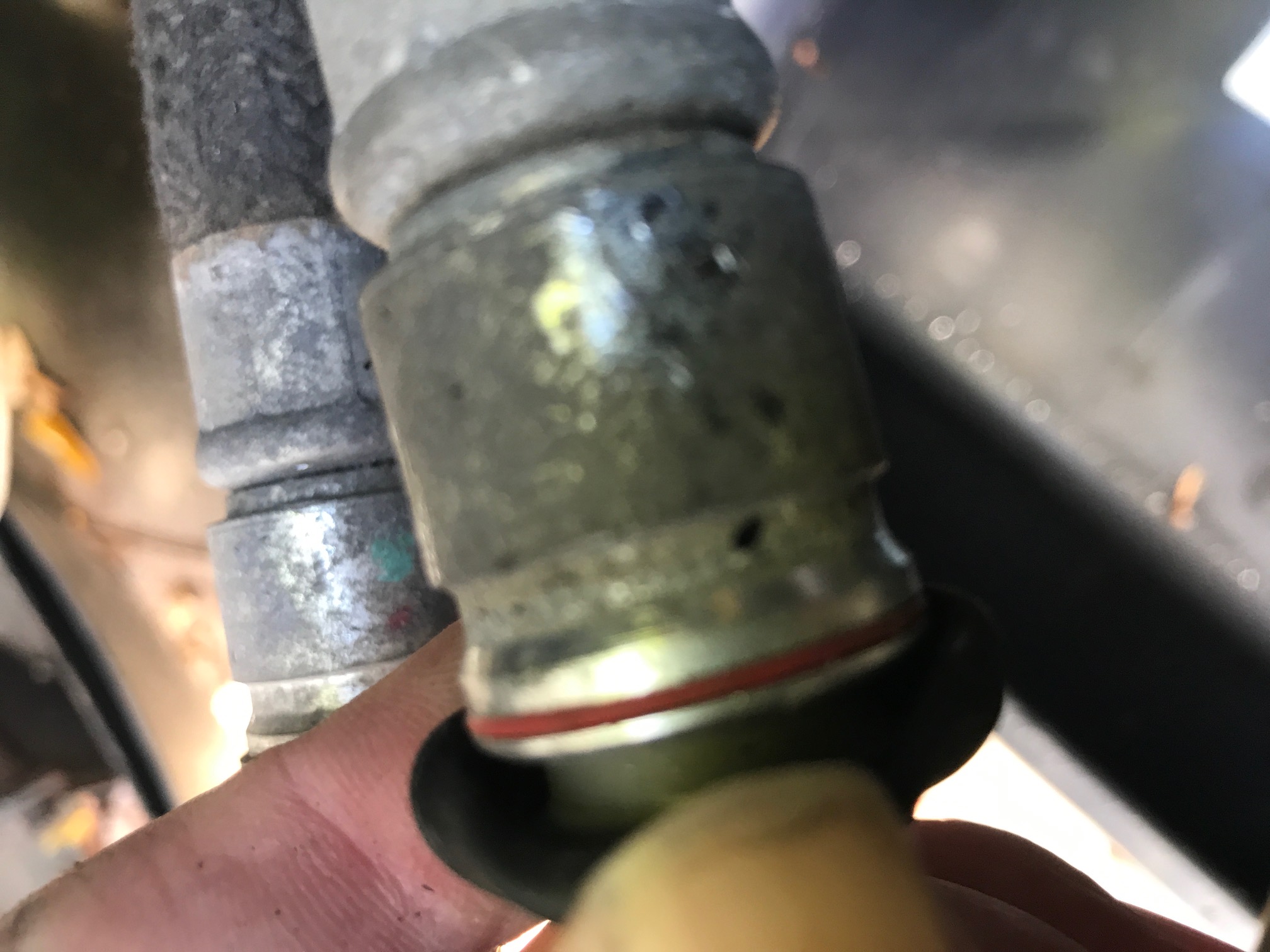

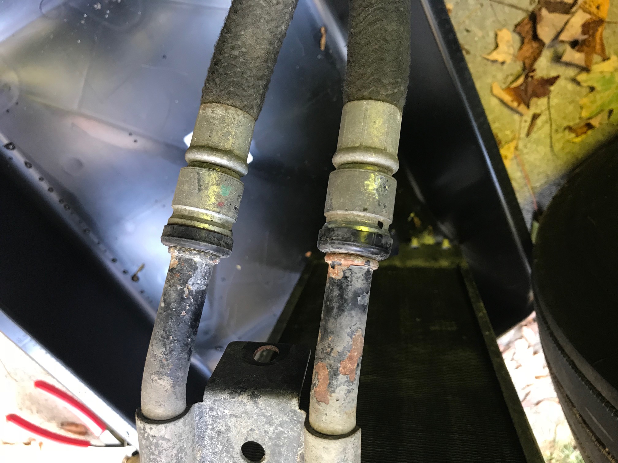

Question, I have the cooler out, HOW THE HELL DO YOU REMOVE THE LINES? LOL!
I called the dealer and they said they just pull apart? Well, HOW? Is there a certain way to do this? Push in and turn? Pull and turn? I'm at a loss. HELP! I need to get back to work.
I pulled the rubber back on the line, and there looks to be a wire wrapped around the Hose Fitting. Not a clip, just a solid wire. Line disconnect tool looks to be needed...
./uploads/201710/post_218_1508171189_ac8ba35e632a480c93c3486f023955d9.jpg./uploads/201710/post_218_1508172599_a5d209f68747316623009f9b1433df2d.jpg
10-16-2017, (Subject: $503.00 for a Transmission Cooler! WTF! )
RE: $503.00 for a Transmission Cooler! WTF!
It looks like you pull back on that sleeve, push the hose in slightly, then pull it back and off.

(10-16-2017 )Waterloo Wrote:  Question, I have the cooler out, HOW THE HELL DO YOU REMOVE THE LINES? LOL!
like this...

Thank YOU RAWZE! Came right apart!
