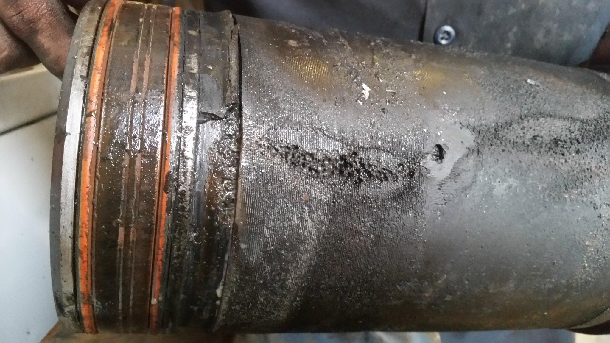

In general --- I have seen destroyed liners form people running straight and/or distilled water on a wet liner enigne!!!!!
and...
It is the NITRATE ADDITIVES IN THE COOLANT that prevent this.
