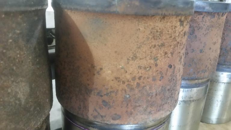

Here is a picture of what happens to liners with neglected coolant systems and no nitrates!...
./uploads/201603/post_2_1458017528_3a62455f3a8a00877dcb310860127283.jpg
(the pitting in this photo is deep enough that coolant started seeping into the cylinders. This happened only a few weeks after someone started using straight water in their engine instead of proper coolant.)

But they do not tell you that it is truly overpriced, horrible stuff!!!---- --- You would think that for $40 a gallon --- THAT IT WOULD ACTUALLY PROTECT YOUR ENGINE IN SOME WAY!!! -- BUT IT DOES NOT!!!
Here is what it did to my liners and block after 600k miles!!!
./uploads/201605/post_2_1463173242_fb0799c5d881030c6b0955fcf5272098.jpg
./uploads/201605/post_2_1463173256_db1e1e8bb032cf23a690f09545ee1464.jpg
I WILL NEVER RUN OR RECOMMEND EVANS TO ANYONE AGAIN!!! -- IT IS HORRIBLE STUFF!
The truck seemed to run cooler,.. but in fact --- it simply was not absorbing heat properly! and it anodized my radiator, and I had to replace that too!.
I had to spend 2 days with paint stripper and rust remover to clean up my block!.
