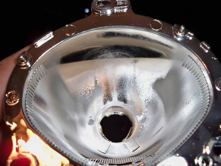

| Volvo headlights As many people with Volvos know, the headlights kinda suck. Recently I tried installing LED bulbs in the place of the H11 low beam bulbs. Shining them on the shop doors I could notice a very distinct difference in light output between the two lights, the left one was about 50 - 60 % the brightness of the right one. I tried running it on the road for a week and there was no real improvement over the old halogen bulbs, it was like the left light was burned out. A couple of days ago I got home and took apart the light and this is what I found on the reflector for the projector. ![]() ![]() A good portion of the reflector has worn or burned away so the light just does not have a chance to get out of the housing. A call to Volvo asking if I could buy just the projector assembly resulted in an ear full of sarcastic laughter from the parts man. The only solution is to buy a new headlight assembly at great cost. At time of calling I was quoted $370.00 (cdn), went in the next day to pick it up and they tried to charge me $477.00. Fortunately I had asked the first guy to put my name on one and he taped a quote sheet to the box so they had to (reluctantly) give it to me for $370.00. Tonight I will find out if the new light make a big difference or only a slight improvement. User's Signature: Too young to quit........Too old to change. | |||

| RE: Volvo headlights Not to sound cheap, But I wonder if that chrome reflective tape Would work ? Go ahead and laugh I understand. LOl I was actually wondering (for at least 4 seconds) if "chrome paint" had made any improvements in looks since my Dad used it 20 years ago. At least with the new light assembly it will be good for another 4 years. With the LED bulb there may be less heat right on the housing so may last even longer. User's Signature: Too young to quit........Too old to change. | |||

| RE: Volvo headlights When my local Volvo dealer first received the LED headlight assemblies they were charging $950 cdn each. After barely tolerating the stock lights last fall I went into my dealer fully intending to walk out with 2 new LED light assemblies. The only small wrinkle was the price had gone up just a wee bit. Grote lights were $1400 each and the Volvo lights were $1600 each. Obviously they want them more than I do. Getting back to my new set up, after a bit of tweaking with the aim I have now spent several hours in the dark and can report the new light assembly makes a huge difference. The bulbs I have in the low beam side are cree LED H11 replacements rated at 1200 lumens with a color of 6500k. I have not been flashed in the two nights and can actually see both sides of the road for the first time in a couple of years. The one thing that has taken a bit of getting used to is adjusting to the difference in the color between the LEDs and the high beam halogen. User's Signature: Too young to quit........Too old to change. | |||
