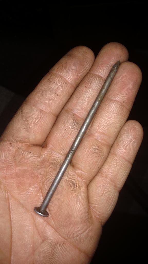

RE: Parking lot injector replacement (01-16-2017 )Hammerhead Wrote: Well, like the title says I'm pretty sure I've got an injector that is giving up on me. I use a nail to pull my injectors and for the oil in the bolt holes I just screw the bolt by it self in to squeeze out the oil | |||
