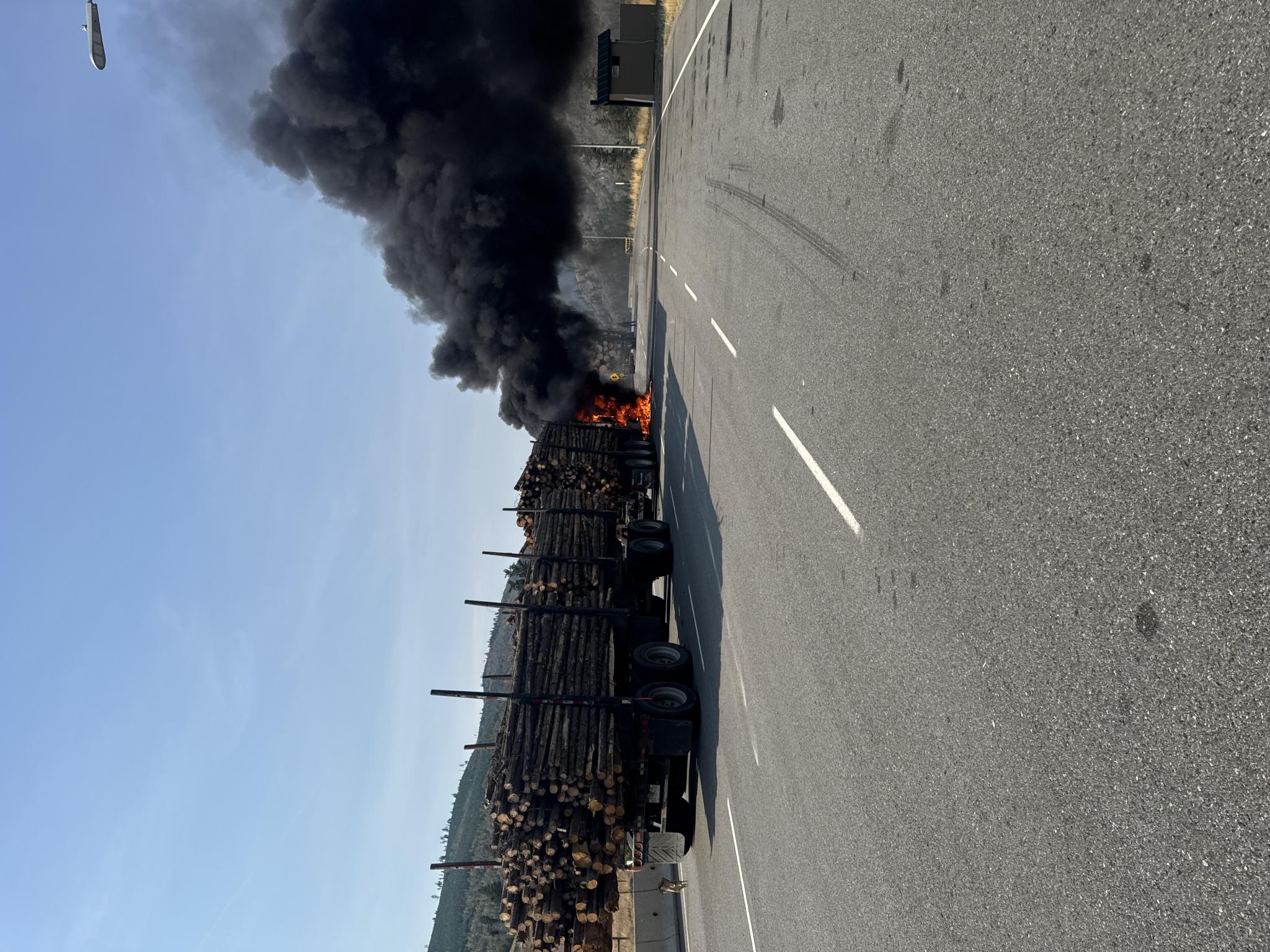

So I’m now at a loss.
If anyone remembers my old profile Ravenwood knows that I had many issues with my 600 CM2350.
1st a horrible demandate tune, then a fuel pump failure that was nearly catastrophic, leaking injectors, a cracked head and multiple cracked injector cups, then a clean tune from Rawze that I just couldn’t get this engine to run properly with. I finally found multiple fuel injector lines letting air in at peak power levels.
It’s been an absolute fuel sipping beast of an engine for the last year but it has all come to an end on August 26th.
So now I have questions
What CM version and CPL would be the toughest and best performing out there. I really liked the way this engine performed after being correctly demandated.
