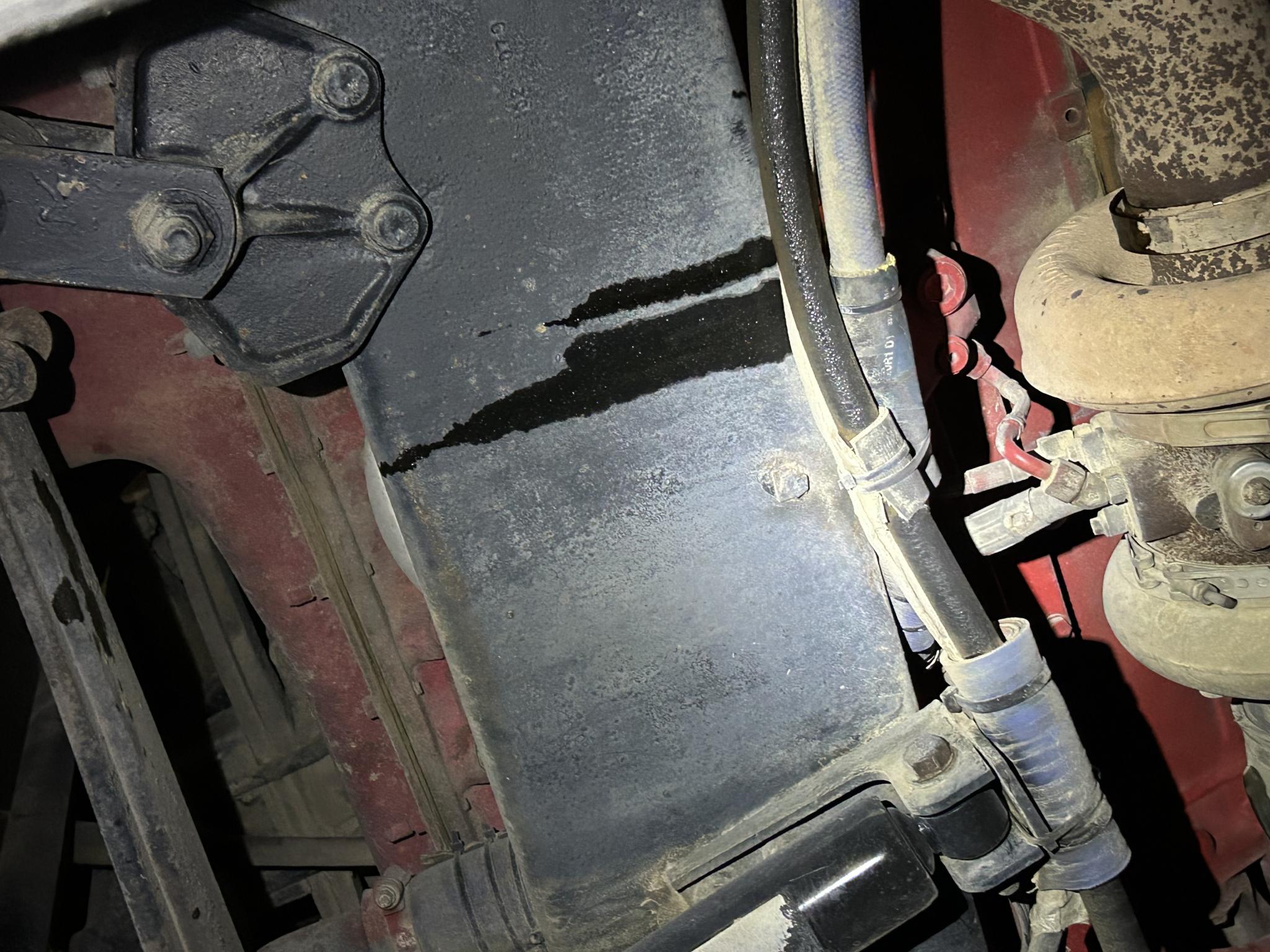

I found oil coming out of the turbo down pipe joint last night. Wasn’t there in the morning when I did my pre trip. I did recently change my exhaust manifold and seals and before the replacement I had leaks around the manifold gaskets but could never tell if it was oil or fuel but now their is no leaks around the gaskets. Could it just be the same fluid going into the manifold and out the rear of the turbo ?

any crank case pressure buildup in the engine can cause turbo to bleed oil.

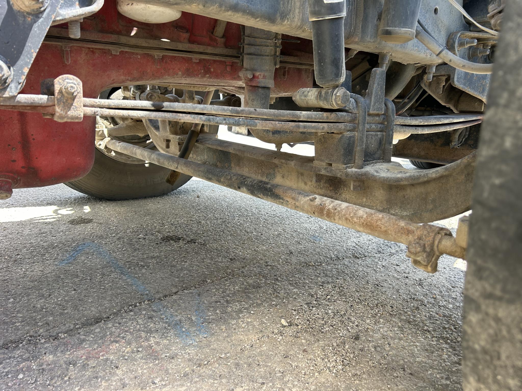

Is it just me?, or does that leaf-spring look worn out in the photo?.
.. on flat parking lot ... take your finger and shove it into the gap between the leafs) on one side to get a feel for how far apart they are spread, where the gap is the biggest .. then do the same on the other at the same place ... see if the gap/spread between each side is the same on both sides. If they are not even then the sprong is worn out, and this can be very dangerous, as it can break under heavy loads.

It’s definitely lost its arch on the side nearest the cab.
