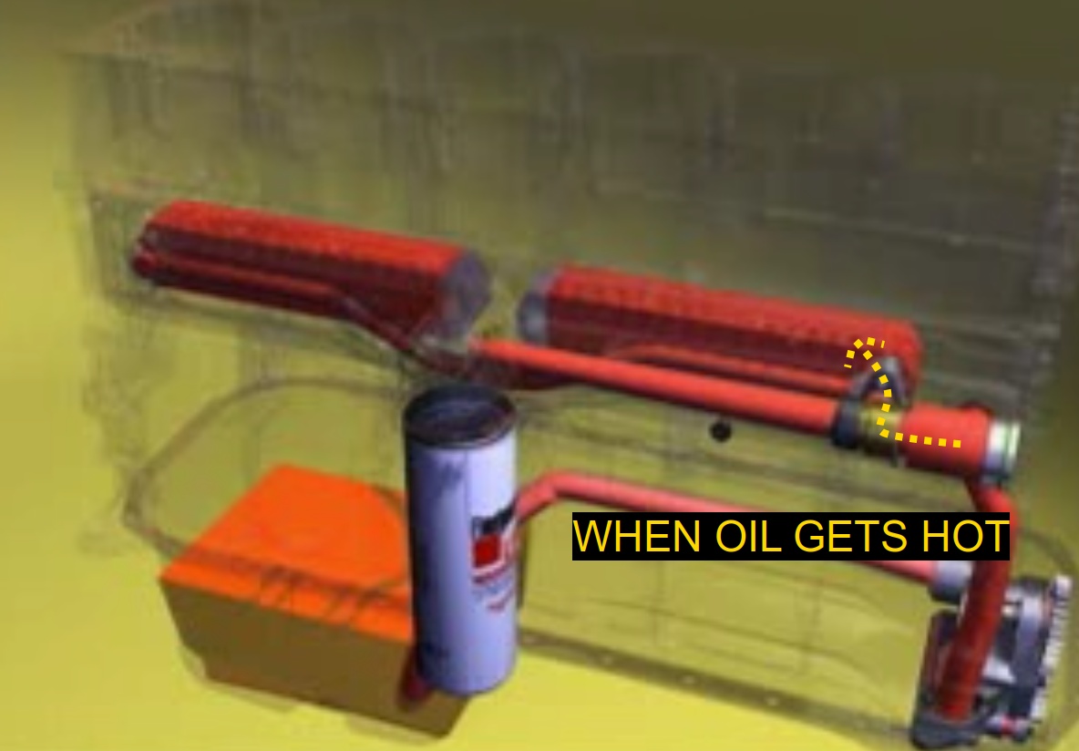

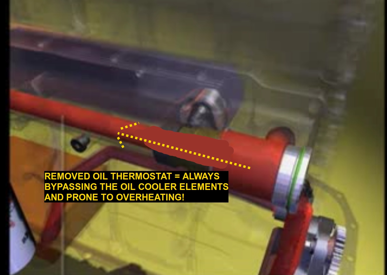

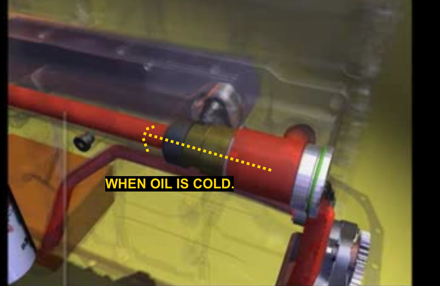

RE: Cm870 (09-21-2023 )Peashooter67 Wrote: Yes The second part of your statement is incorrect and was removed. (09-21-2023 )Benjamin9669 Wrote: ... 3 weeks ago we had the oil cooler done, “claims there is no thermostat”. My only question. Wouldn’t a truck with no oil thermostat run 210-215? Not 240-245?. ...Also.. you are incorrect as well, because some complete dips#it must have given you some bad information, and if they removed that oil thermostat.. YOU NEED TO RE-INSTALL IT A.S.A.P!@. =========== IF the oil thermostat was removed or missing,.. the oil will overheat on a whim. This is because the oil thermostat is normally open and BYPASSING THE OIL COOLER!... ![]() .. AND CLOSES AS THE OIL GETS HOT... BLOCKING OFF THE BYPASS CIRCUIT AND FORCING THE OIL thru the oil cooler as it gets hot. ![]() I.E.> ... WITHOUT THE OIL THERMOSTAT INSTALLED.. THE OIL WILL OVERHEAT VERY QUICKLY because there is nothing at all forcing it thru the oil cooler any more, AND THE BYPASS CIRCUIT THAT IT SITS IN, IS ALWAYS WIDE OPEN!. ![]() If some complete dumb$tard told you to remove it, or that it did not have one, then they are a complete idiot!. User's Signature: ->: What I post is just my own thoughts and Opinions! --- I AM Full Of S__T!. | |||

RE: Cm870 (09-21-2023 )Benjamin9669 Wrote: Before you go assuming. No. I am just going off what the dumbass said. He said “there is no tsat” on these 870’s. “It depends on the climate”. I am literally just going off what the dumb ass said. I know they have a tstat. I tried telling him there is one. Many times. You need to ensure that whoever did the oil coolers made sure the thermostat was installed... and that it was functioning properly. NOTE: Some ISX models only have a single oil cooler element in them, some have dual elements. Depends on application, but ALL ISX's have an oil thermostat, and a minimum of at least ONE oil cooler element. You stated you "had the oil cooler done".. and that some complete idiot told you that there was no thermostat?. This would make me really question their ability to work on these engines.. as EVERY SINGLE CM870 ISX HAS a DAMN OIL THERMOSTAT!!!.. AND IF THEY SAID THAT NOT ALL OF THEM DO, >>> then for all you know at this point.. it could now be missing!. The oil does not overheat as badly as you describe unless something is very wrong. A missing oil thermostat after the oil coolers were re-done, could very well be the case. People do dumb things!... They do stupid s$it like removing the oil thermostat, so if you are not the sole original owner of the truck since brand new .. someone somewhere .. or that idiot who did the oil coolers.. could have very well removed it like a dumb s$it .. and this certainly would cause the oil overheating issues that you are asking about. It could also simply be that the oil thermostat that is stuck open, and failing too. SO..,. the next step, after verifying that it is actually overheating (oil temp sensor is not reading higher than it should), it looks to me, like it is to replace the oil thermostat and go from there... and believe me, replacing that oil thermostat is not such an easy task. User's Signature: ->: What I post is just my own thoughts and Opinions! --- I AM Full Of S__T!. | |||
