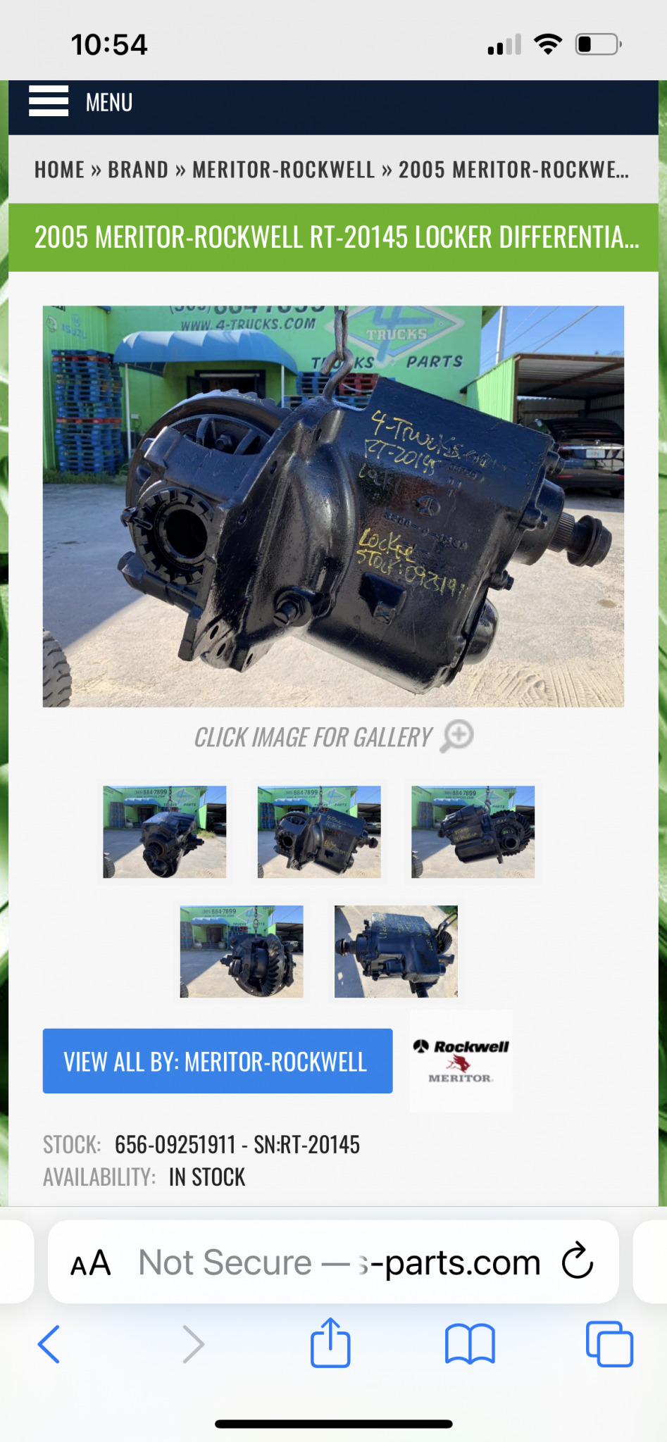

| RE: Tune a stock mandated 2350 Good info all around! Greatly appreciate it. I thought about this already and had people telling me to just run these until they start going out. Little truth to just go with your gut. Y’all very knowledgeable and I’m learning A LOT from this page. Enjoy the no B.S and just the truth no what you want to hear. I do plan to go to a 18 speed as well in the future when my current trans starts to go (if it gives a warning) Best place to search for 18 speed trans ? I’m wondering if there’s much of a difference with the years for rearends ? Would something like this work for the front rear ? Currently have “2017 MD2014x 325’s” just curious as to what is interchangeable This is a “USED 2005 RT-20145 FRONT MERITOR-ROCKWELL NEW WORLD DIFFERENTIAL WITH R:3,90 LOCKER, COMPLETE, INSPECTED READY TO WORK.” | |||

RE: Tune a stock mandated 2350 (12-12-2022 )BrandonOlsen Wrote: I’m wondering if there’s much of a difference with the years for rearends ? Would something like this work for the front rear ? Currently have “2017 MD2014x 325’s” just curious as to what is interchangeable That for sale link is for the older style Meritor axle. Yours is the newer model they have been using for the last 10 years or so. The newer ones do cost more to replace than the older ones and they are NOT interchangeable. User's Signature: Born and raised in Vyskonsin on milk, cheese, bread, and beer! | |||
