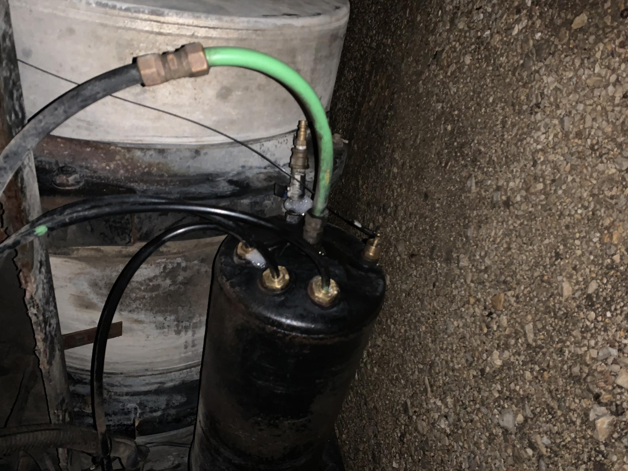

| RE: 04’ cm870 air compressor keeps breaking So what I have found is small leaks similar to this one.The check valve where the hose is connected is a day old.How do I stop a leak like this one? | |||

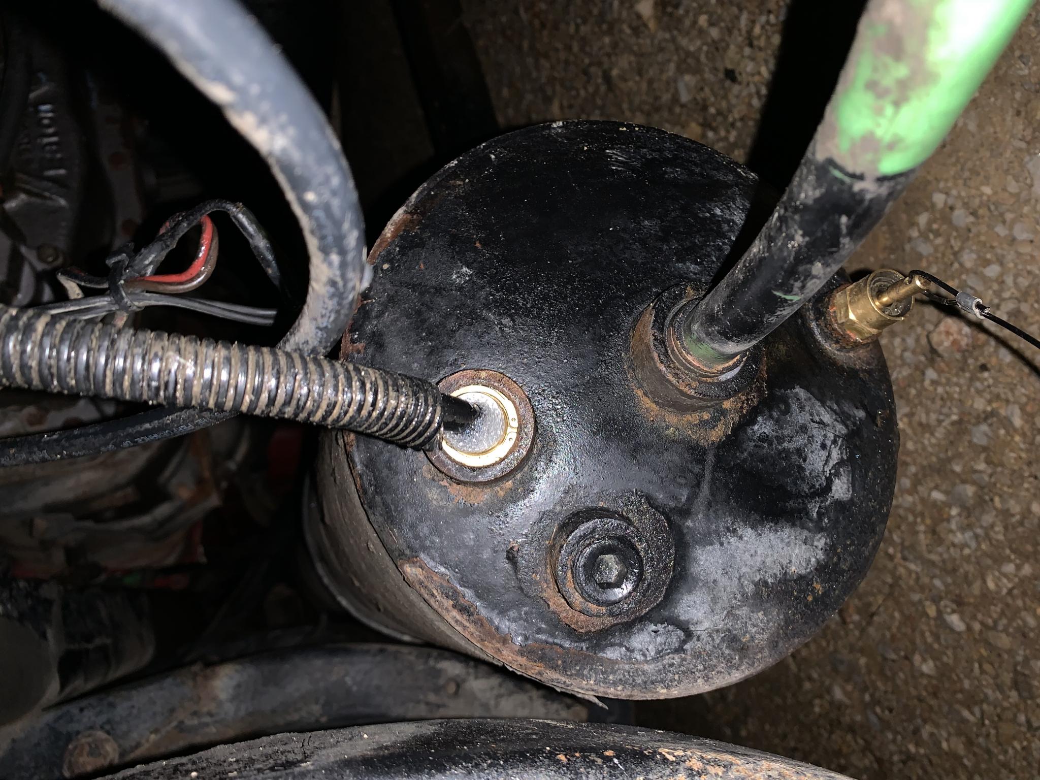

| RE: 04’ cm870 air compressor keeps breaking This is the other tank.All fittings on that tank are less than a month old.The valve is an easy fix but what about the other ones? | |||

| RE: 04’ cm870 air compressor keeps breaking I bought a brand new pete 567 3 years ago, all the fittings have leaked just like those since the day I got it. Crappy fittings from our friends in Asia. | |||
