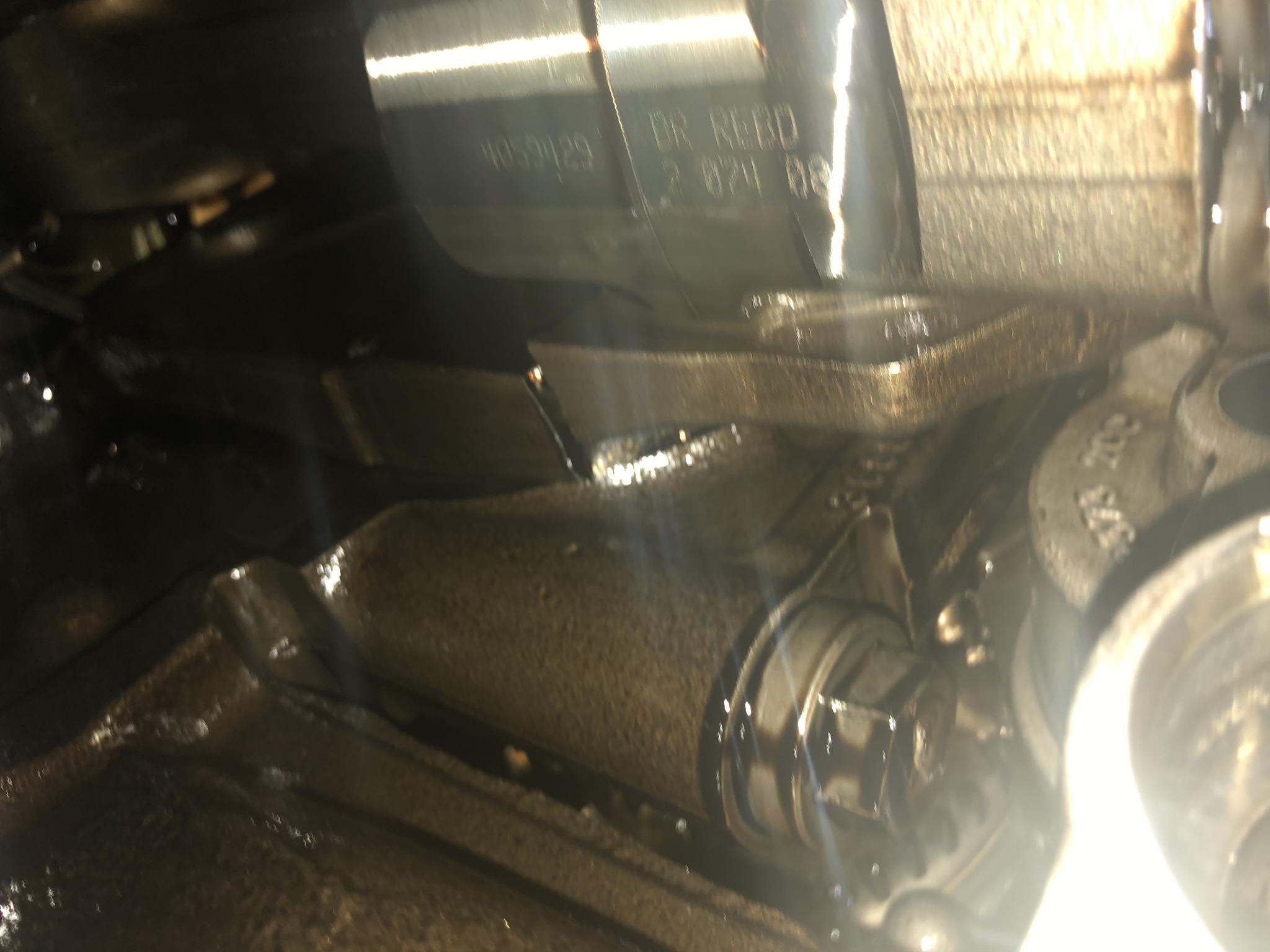

| RE: Another oil pressure thread Unfortunately Mr. Rawze all I have is enough money to buy a used running motor to put back in it. I wish I had deep enough pockets to do as you suggested. I never fully recovered financially from my oil pressure fiasco. This last year has been so slow that I’ve let go and sold off my other trucks. This one was running great with no issues for the whole year. I understand your point of view. I really do. He and I followed to the letter from commins how to put this motor together. All I can afford at this time is to buy a running motor out of a wrecked truck and make sure the ecm program is a good one. Just pulled the pan off and can’t see at the moment why the crank is moving around. My bet will be that The crank broke. User's Signature: Have you checked your muffler bearings today? | |||
| 02-04-2020, (Subject: Another oil pressure thread ) Post: #61 | |||
| RE: Another oil pressure thread Rawze You may have jumper the gun on me. I/we got the bottom of the motor open. The crank shaft broke between the #1 rod and the #1 main about half way up between the two. This was from a flaw in the crankshaft. User's Signature: Have you checked your muffler bearings today? | |||
| 02-04-2020, (Subject: Another oil pressure thread ) Post: #62 | |||
| RE: Another oil pressure thread Was the balancer new or original? User's Signature: 2010 Lonestar - CM871 - 13sp - 3.70s, 2016 T680 - cm2350 - 13sp - 3.36s - skateboarder | |||
| 02-04-2020, (Subject: Another oil pressure thread ) Post: #63 | |||
| RE: Another oil pressure thread New. I tried following everything I could from here when we put my motor back together to avoid any future issues. New oil pump new balancer the list was really long. Spent a lot of money to make this motor right so it would last. We are taking the block down to remove it from the truck. Inspection of balancer will be next. User's Signature: Have you checked your muffler bearings today? | |||
