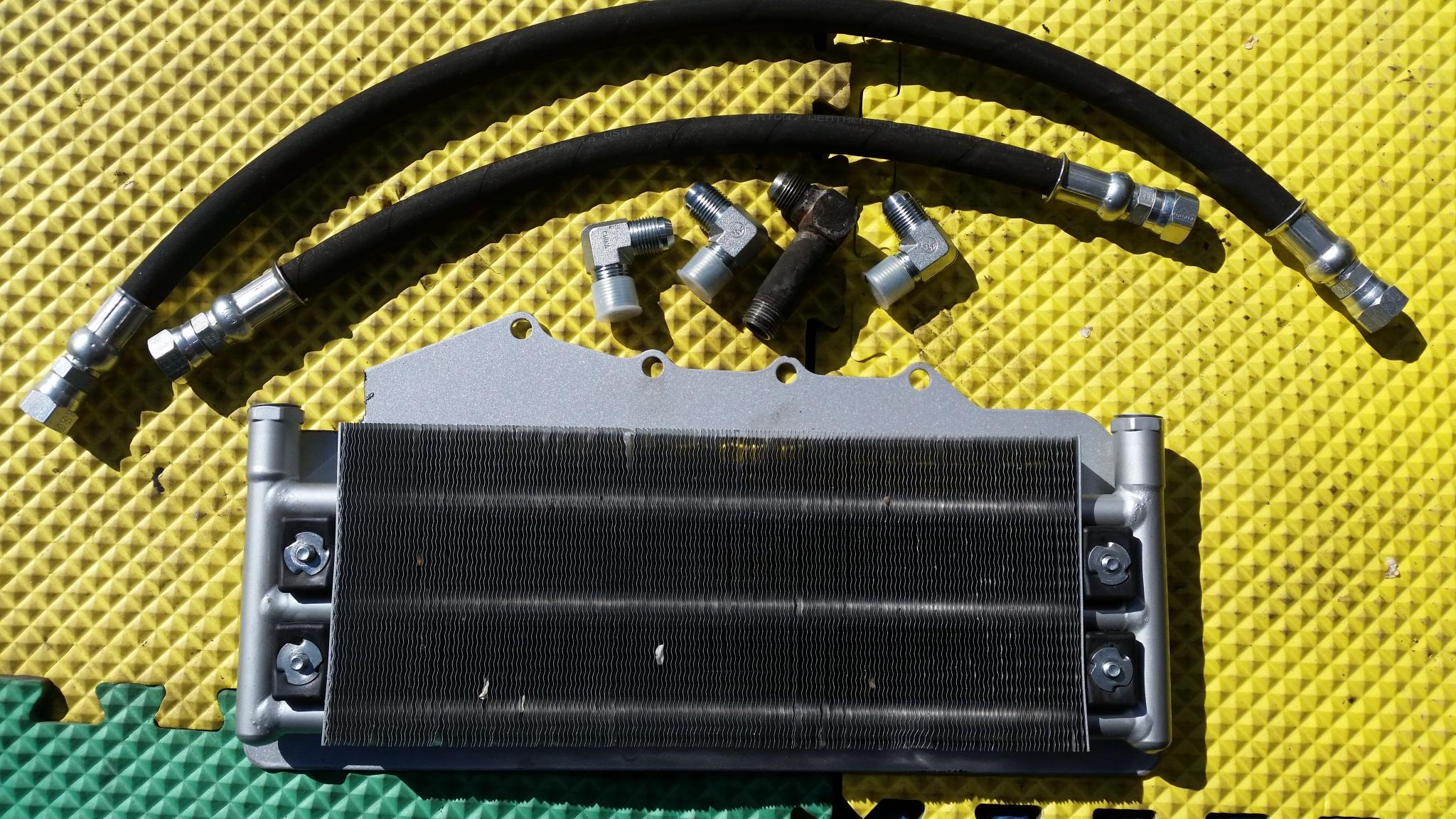

| RE: My Pete rebuild I can't count how many times I've heard diesel mechanics say that they hate (or won't) work on autos. I can say that without a doubt, I'm the opposite. As much as I hate VW's maze of nazi engineering, I'd rather diagnose and repair those every single day than have to do this 6 days a week lol. I took advice from a respected mechanic that he adds a little sealant on the clutch housing gasket - BAD. If it wasn't for my OCD paranoia that caused me to pull it off (again), I would have had a nasty leak in no time. Despite the fact that I put a VERY small film around the oil port section, it was enough that when torqued down, it dislodged and moved the rubber gasket inwards on the tight radius. I'd take a picture, but I may have thrown the gasket a couple of times and then crumpled it up like a pop can lol. I thought by this point, the feel goods would start as I'm on the home stretch of assembly, but I'm still waiting. ![]() In the meantime, I've been looking at this ugly heat exchanger... ![]() I was going to go with an air cooler, but I would want solid lines running the rail up to the radiator. I wish they made Nicopp lines bigger than 3/8, but for the price of a coil of stainless, and all of the fittings, I'm just going to stick with the liquid cooler and plan on changing it out at 4-500k. | |||

| RE: My Pete rebuild That tranny cooler is the same one I have. I replaced it and painted the new one. Now that I'm doing the motor, I had to pull the transmission. I'm gonna rebuild it while it's out. I replaced all my hoses with blue silicone, and clamps with stainless constant torque style. They say those coolers are transmission killers because they can fill your tranny with coolant if you have a leak. Mine had 697000 on it before I replaced it, so I'll be comfortable with the new one for a while anyway. | |||

| RE: My Pete rebuild This one put around 3? Pints of coolant in the trans. It probably happened while it's been sitting the last 3-4 years. I plan to cut it open to see exactly where it failed. I like the heat exchanger idea since it's a more uniform, consistent temp. | |||

| RE: My Pete rebuild I have seen a lot of failures and ruined trannies due to those heat exchangers that use coolant. Unless there is a specific reason to use one (regular extreme environments, extreme duty operations, etc.. that may require one) ... I usually tell people to get rid of those type of tranny coolers and replace them with an air-cooled one. The junkyard (kerns) in Atlanta,GA here has an air-cool conversion kit that bolts right to the back of the tranny that works very well for people hauling 80,000 lb freight in highway applicatins. No need to run hoses up to the front of the truck... or it can be mounted up to the front w longer lines if better cooling is needed. I think the cooler element itself is a hayden?.. https://www.ebay.com/p/Engine-Oil-Cooler.../168690744 and the backing plate, not sure. Maybe call Kerns junkyard in atlanta and ask them?. User's Signature: ->: What I post is just my own thoughts and Opinions! --- I AM Full Of S__T!. | |||
