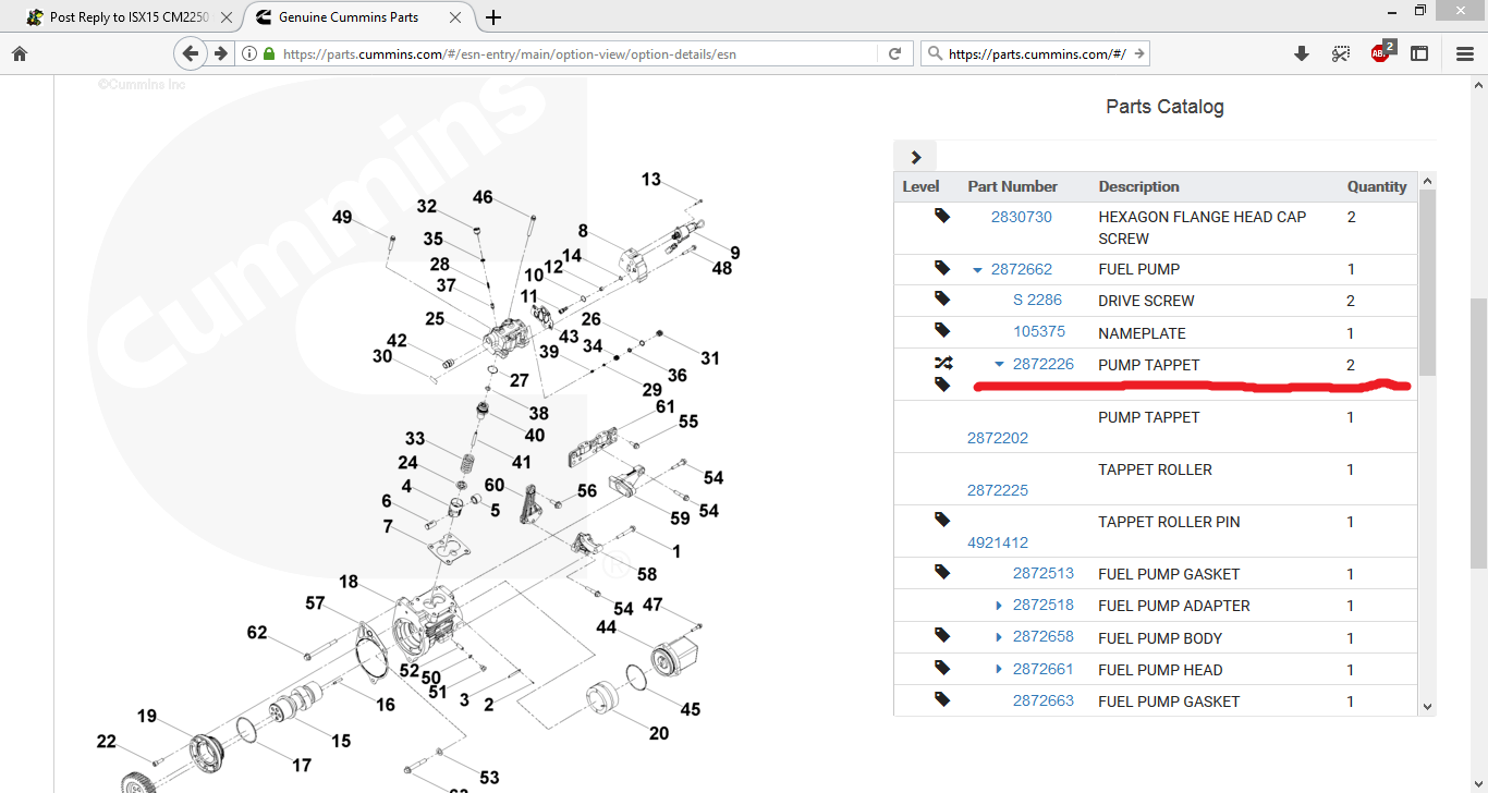

| RE: ISX15 CM2250 fuel pump timeframe? The only thing I need are the fuel lines now. does anybody have the part numbers for them? Also, is there any special brackets that I need? any info would be appreciated As quickserve doesn’t show the two cylinder pump for me. User's Signature: Born and raised in Vyskonsin on milk, cheese, bread, and beer! | |||
| 04-16-2018, (Subject: ISX15 CM2250 fuel pump timeframe? ) Post: #51 | |||
RE: ISX15 CM2250 fuel pump timeframe? (04-16-2018 )Volvo8873 Wrote: The only thing I need are the fuel lines now. does anybody have the part numbers for them? Also, is there any special brackets that I need? any info would be appreciated As quickserve doesn’t show the two cylinder pump for me.Go to https://parts.cummins.com/#/ Engine parts/ Put ESN in search window/ Fuel system | |||
| 04-16-2018, (Subject: ISX15 CM2250 fuel pump timeframe? ) Post: #52 | |||
RE: ISX15 CM2250 fuel pump timeframe? (04-16-2018 )snailexpress Wrote:(04-16-2018 )Volvo8873 Wrote: The only thing I need are the fuel lines now. does anybody have the part numbers for them? Also, is there any special brackets that I need? any info would be appreciated As quickserve doesn’t show the two cylinder pump for me.Go to https://parts.cummins.com/#/ Already did that and comes up showing the three cylinder pump and accesories. Ill head over to the dealer in the morning and see what they have to offer. User's Signature: Born and raised in Vyskonsin on milk, cheese, bread, and beer! | |||
| 04-17-2018, (Subject: ISX15 CM2250 fuel pump timeframe? ) Post: #53 | |||
RE: ISX15 CM2250 fuel pump timeframe? (04-16-2018 )Volvo8873 Wrote:For my 2250 build 2012 it shows 2 cyl pump with all associated brackets and pipes.(04-16-2018 )snailexpress Wrote:(04-16-2018 )Volvo8873 Wrote: The only thing I need are the fuel lines now. does anybody have the part numbers for them? Also, is there any special brackets that I need? any info would be appreciated As quickserve doesn’t show the two cylinder pump for me.Go to https://parts.cummins.com/#/ | |||
