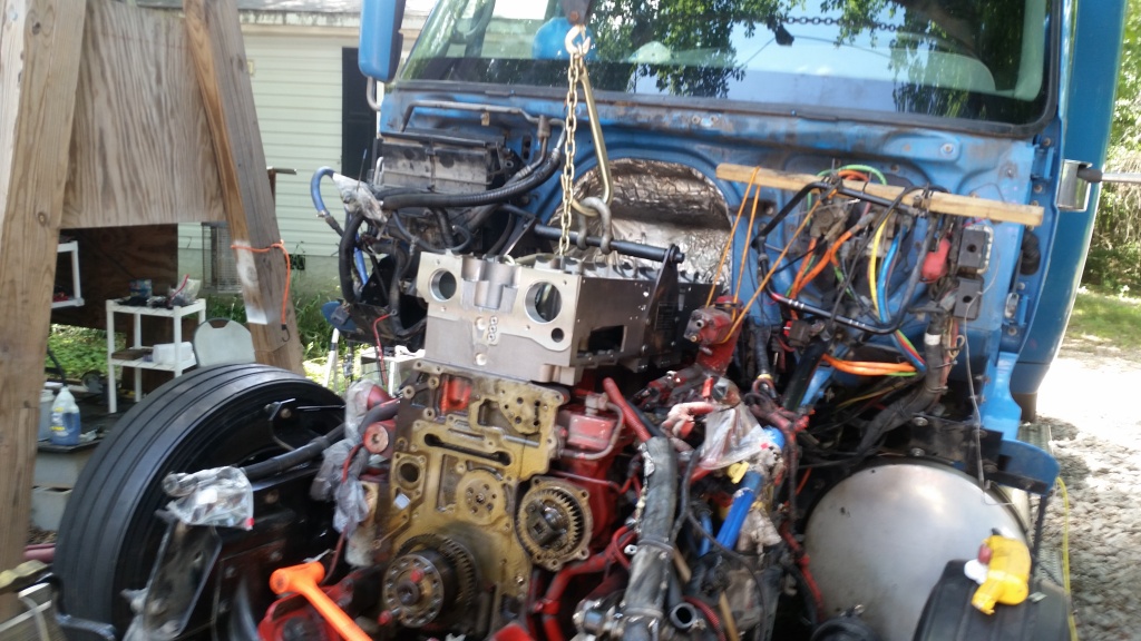

RE: Teaching 74bassman how to do an inframe Monday (10th), tue(11th), not much got done. I think 74bassman was cleaning parts and doing things at his home, it rained a lot during those days too. Wednesday he spent some time cleaning up the block and got new main bearings installed. Yesterday (13'th), I helped him install new liners, pistons, rod bearings, new cooling nozzles, anti-polish rings, head gasket, and head. - We torqued the head to 300 ft-lbs, so that it can sit over night and the head gasket crush before re-torquing it again in the morning. After that, We will turn the bolts another 90 degrees for the final head bolt settings. ![]() User's Signature: ->: What I post is just my own thoughts and Opinions! --- I AM Full Of S__T!. | |||

RE: Teaching 74bassman how to do an inframe Few questions. New head or remachined? New head bolts or reuse? When putting in the piston rings do you have to orientate them in a certain way? And the wrist pins, what does the shop do or have that you don't have at the house? I think of them as with a pin held in with a snap ring. Also when it comes to the liners, you do yours different then most right, you use the gauges to measure how far they are tapped inside the chamber hole. Do some shade tree guys just feel it by hand to see if it is flush and call it good?? User's Signature: Also known as Shotgun | |||

RE: Teaching 74bassman how to do an inframe (06-14-2019 )flatbed94kid Wrote: Few questions. Watch Rawze's inframe video series on YouTube. All those questions are answered. | |||

RE: Teaching 74bassman how to do an inframe (06-14-2019 )flatbed94kid Wrote: Few questions.Like mention before watch rawze video. Also create you an account with quick serve and read up on there it will break entire engine down and give all needed info... Id do that first then watch his video..... | |||

RE: Teaching 74bassman how to do an inframe Front structure is off but the air compressor and crank hub is still on. I never would have guessed you could do that. I want to do mine in something like por-15 red. How much does a rebush cost on those rods out of curiosity? I thought that cummins was the only game in town on ISX rods. Is that typically the only process involved, or is resizing and bolt replacement, etc on the table for them too? User's Signature: 2010 T2000, CM871, 13spd, 977k, tanker yanker Overhauled @ 927k | |||
