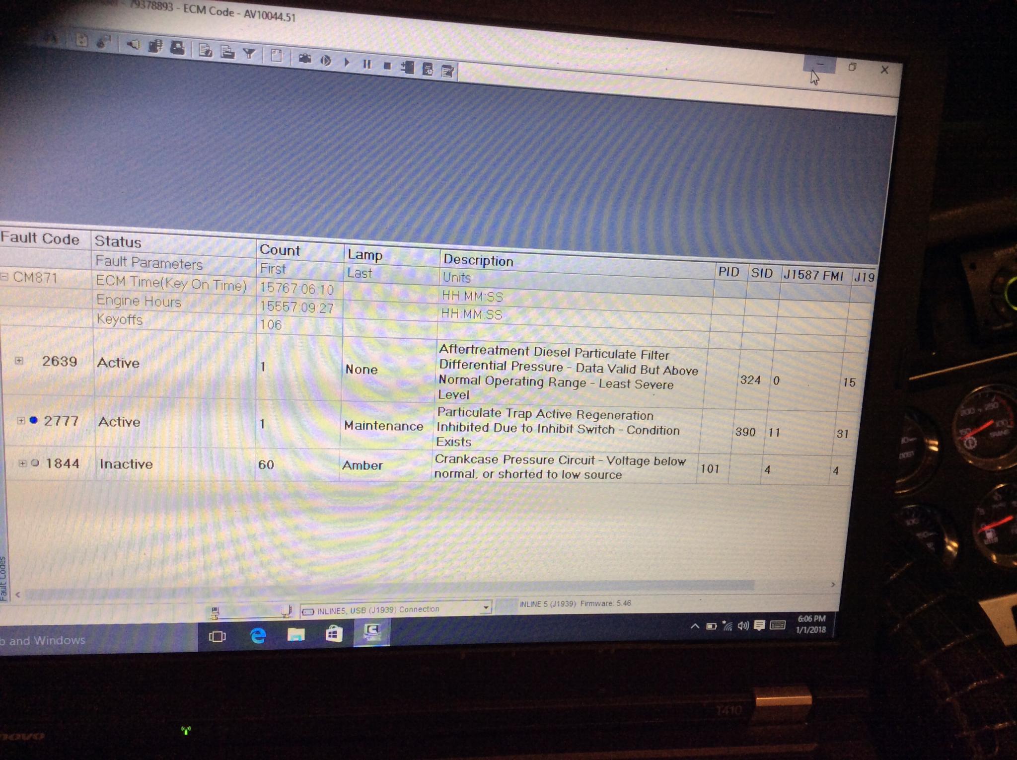

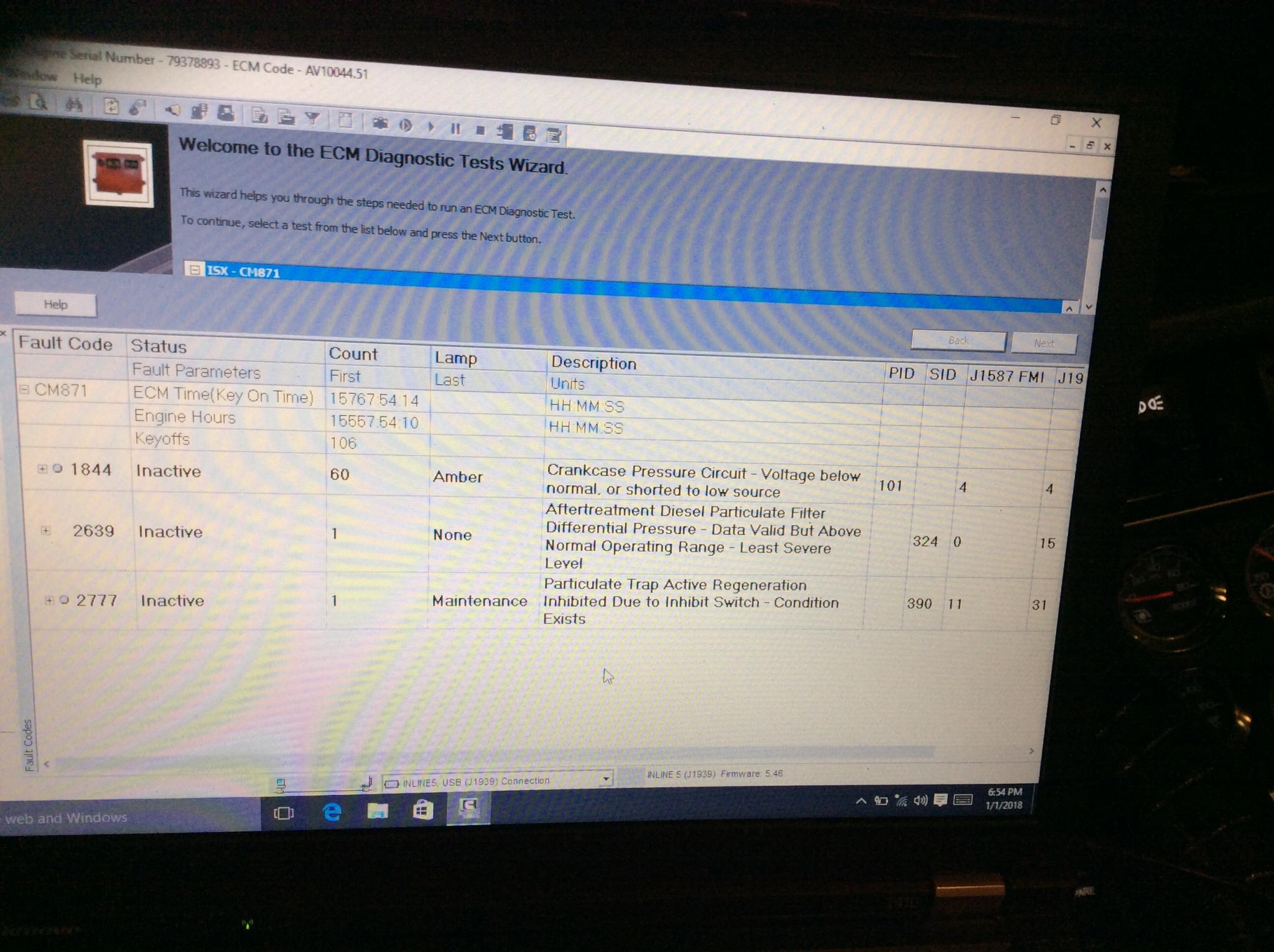

01-04-2018, (Subject: Regen light on )
Post: #36
RE: Regen light on
Ok,
Went 950 miles since reset on ecm and can and the DPF light is screaming again...
Did a forced regen, and sure getting tired of this. Also have fault code 2777, which points to a problem involving the inhibit switch. The inhibit switch will not allow me to do a forced regen, so I have utilize Insite to complete the task. Insite says something about ecm programming for the inhibit switch, yet I had ecm flashed to the correct av10046. I'm thinking maybe I have a bad inhibit switch on the dash, since I can not do a forced regen when pressing the rocker switch.
Thx in advance
