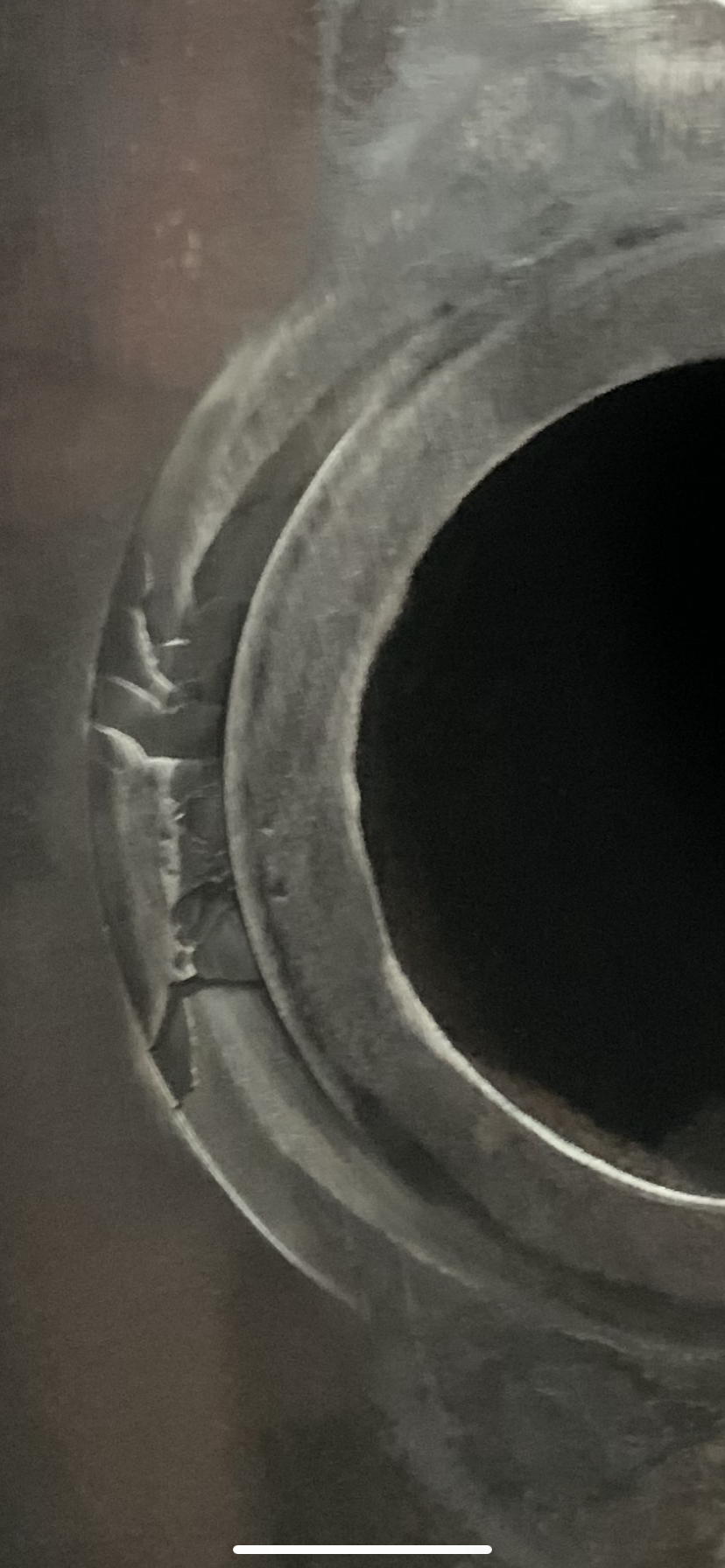

RE: Cm2350 Yup Cummins doesn’t care how the engine goes out they just hope it makes it out of the warranty period. Wish I knew how to add pics. My head is getting replaced Monday from a casting defect that they should have obviously seen while putting it together but shipped it out anyway. Hated buying the extended warranty but glad I did after this discovery. Took some arguing and stood my ground but they are replacing it. | |||

11-30-2020, (Subject: Cm2350 ) Post: #18 | |||
RE: Cm2350 ![]() | |||
