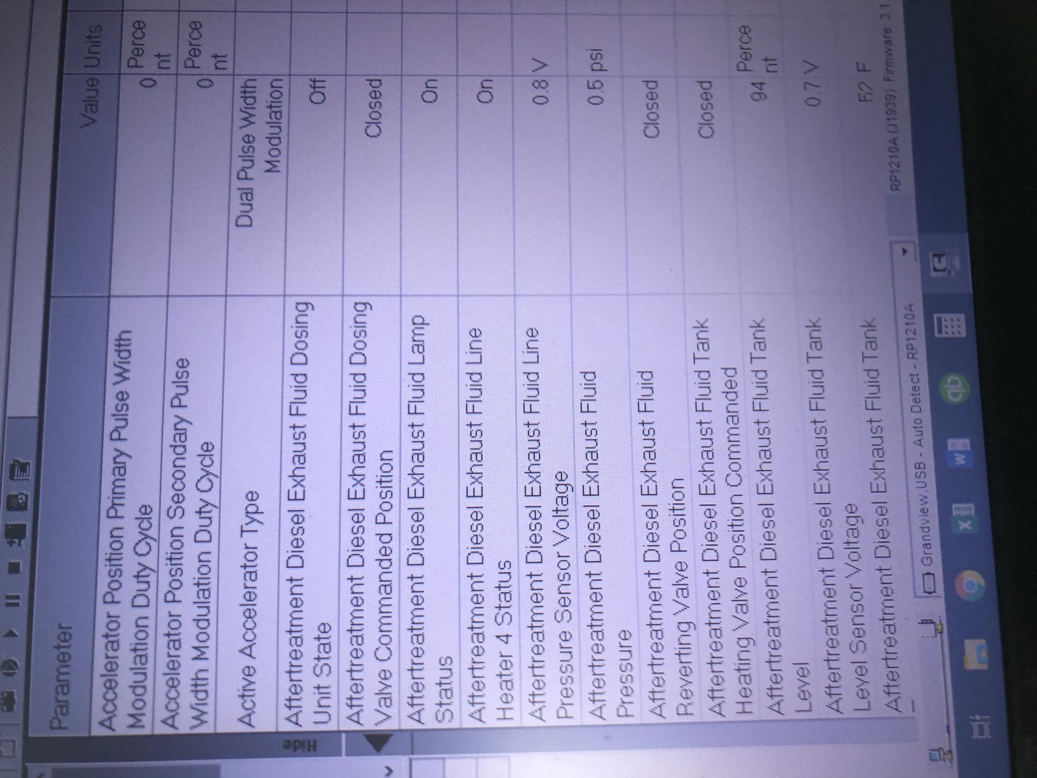

RE: Inactive Doser Valve (03-15-2020 )Rawze Wrote:(03-15-2020 )kozakvod Wrote: Is there anything i can do to prevent that full derate to get home or is that simply ill advised? This is what it’s currently reading. | |||

| RE: Inactive Doser Valve I was BARELY able to get up underneath it and reach the connector on the doser. I pulled it but thats ALL i could do. Drive line prevents visually seeing inside it, cant get my head to it. Anyway, I pulled the connector plugged it back in to assure it was tight. Seemed so. Came back to insite after key off and on codes now inactive again and red light is off. The new image shows doser status “dosing” Doser valve position “closed” Guess ill try a test drive again. See what it does. | |||

| RE: Inactive Doser Valve 10 mile test drive watching insite. Doser valve did pulse open closed open etc. No return of faults this far. | |||
