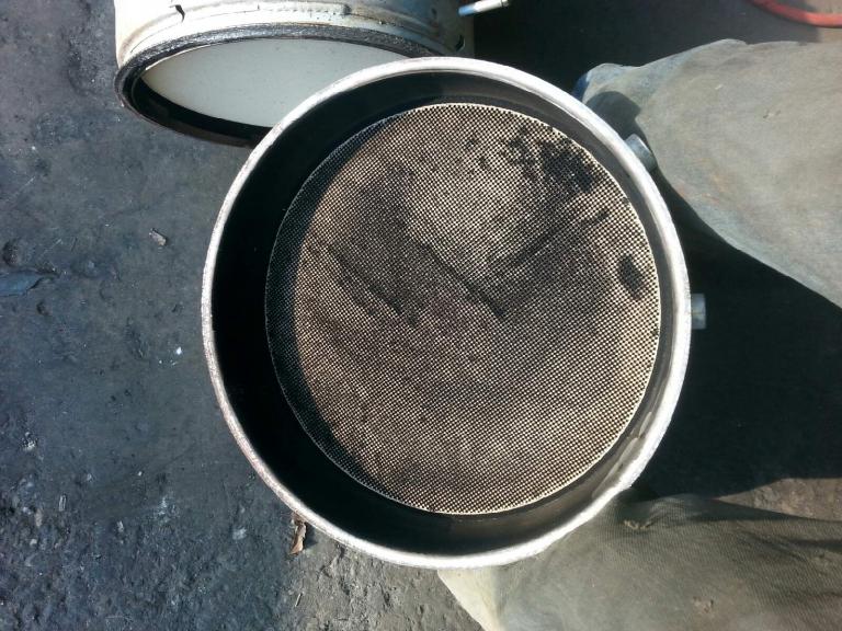

| 12-17-2016, (Subject: I SX 2350 regen issues – please help! ) Post: #17 | |||
| RE: I SX 2350 regen issues – please help! If I do this right here is what the DPF look like when we took it out last week. It was last baked in September | |||
| 12-17-2016, (Subject: I SX 2350 regen issues – please help! ) Post: #18 | |||
| RE: I SX 2350 regen issues – please help! Looks like you have some cracking going on....internally. The soot lines and the two small soot patches are signs that the soot is being blocked due to the flow being interrupted by the cracking. Also, who resealed the DOC? Look at the gasket...it looks like whoever did it didn't seal it properly... IMHO... User's Signature: You want how much? | |||
