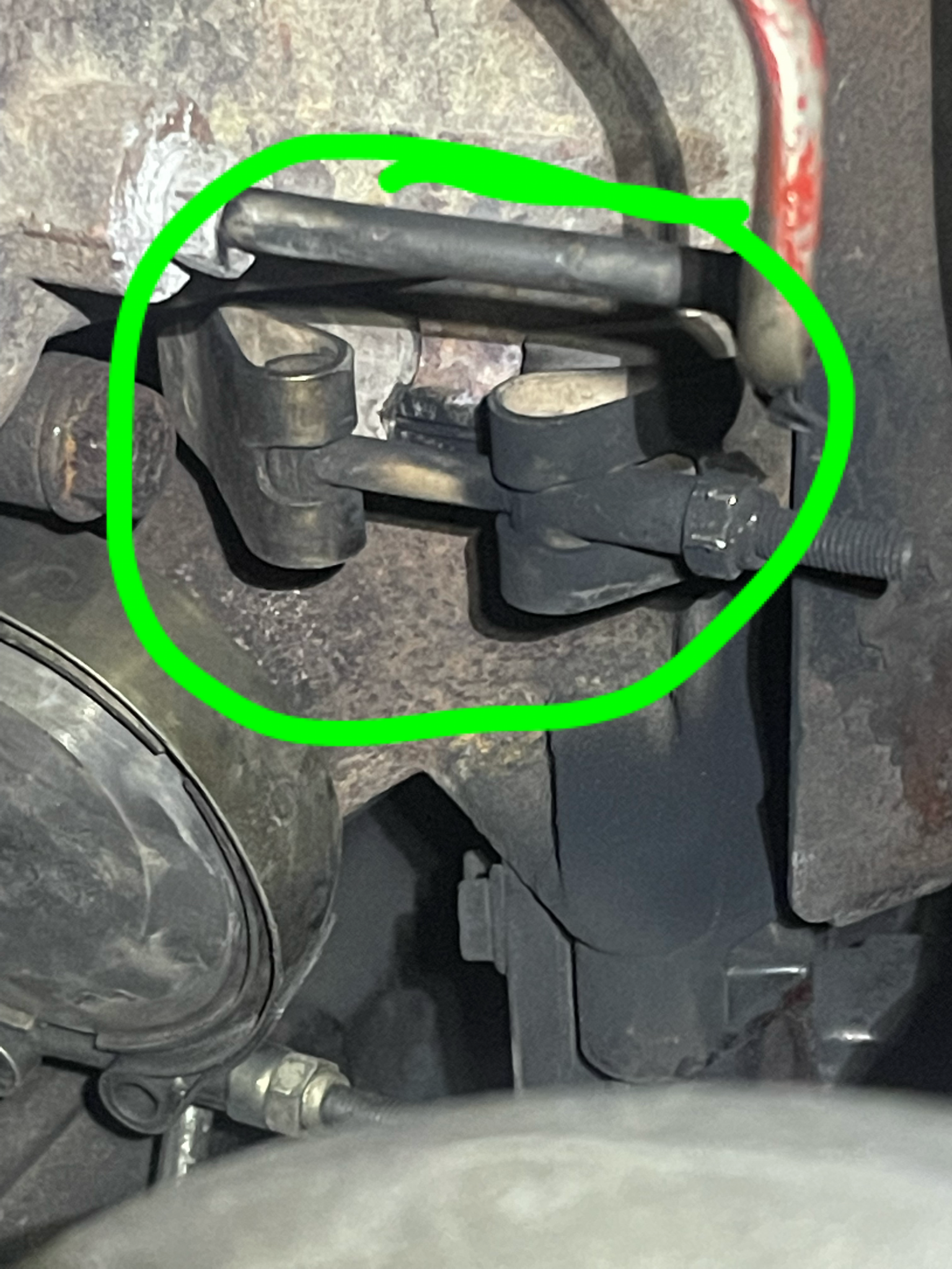

| RE: Very strange smell. Stumped Well I found one major leak. Rawze is this one of the connections you were talking about that has a gasket or an o-ring? It’s the clamp on the end of the exhaust manifold just above where the EGR cooler used to connect. Check picture below. Also found that my heater box has serious rust issues on top. Couldn’t be seen from the ground so I’m guessing this might be where the fumes are coming in. | |||
