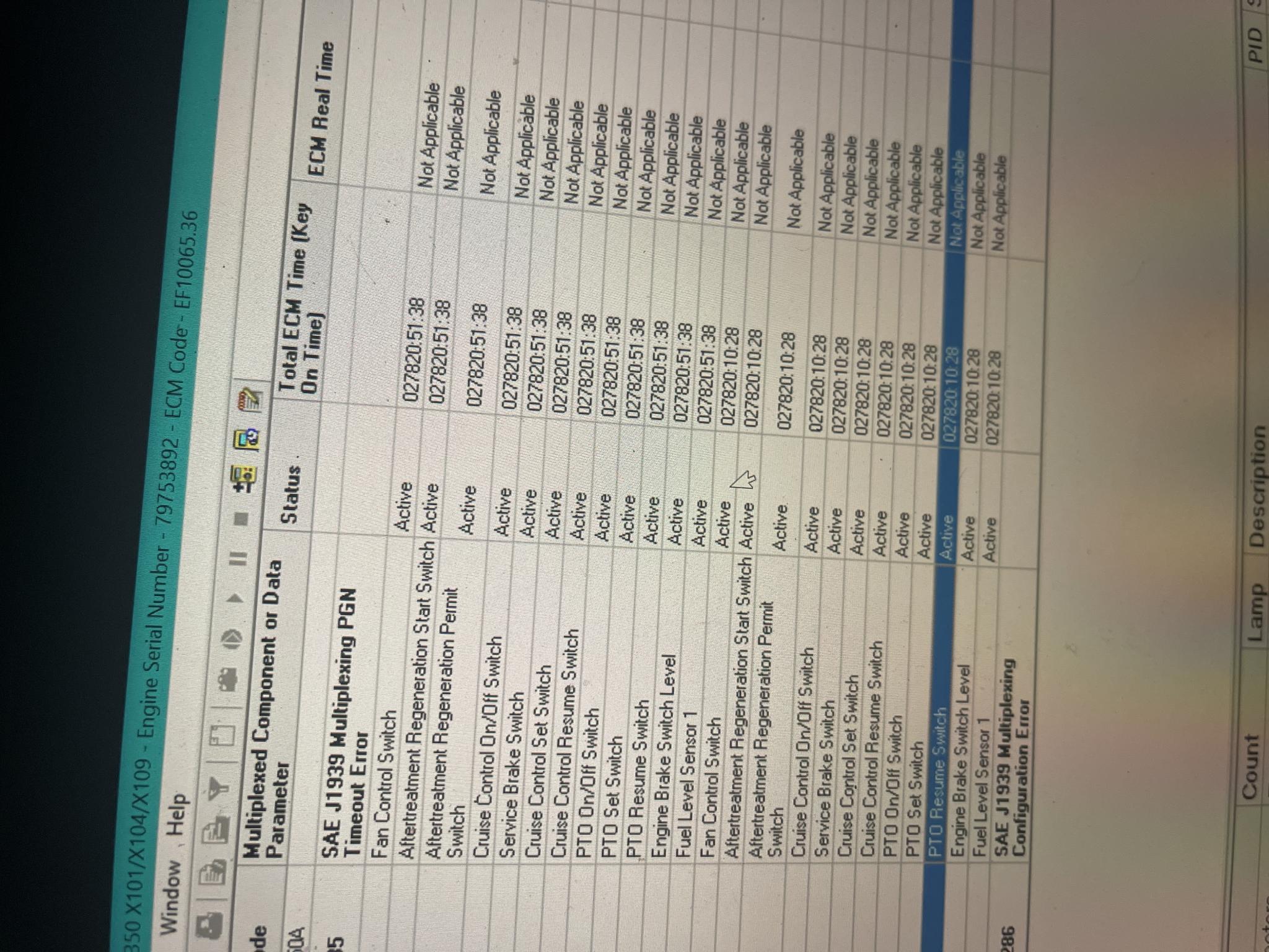

RE: Stumped on no CC or Jake brake (09-20-2022 )SRTDiesel Wrote:(09-20-2022 )Colter Wrote: It sounds like there was an issue in the past while flashing in regards to the ECMs template, if its lost that information reloading a calibration will just carry over the same information or lack thereof. What id start with is find someone with the same truck and engine and pull the template from that ECM and write it into yours. It’s giving me a 0285 FMI 9 code with about 20 things listed as active. Essentially anything that is enabled in SAE j1939 multiplexing in parameters in insite it’s showing a code for. | |||
