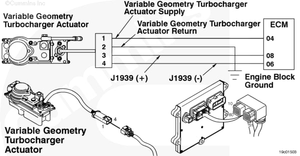

RE: VGT Actuator Issues (08-10-2022 )Rawze Wrote: Is it giving you positioning errors?.. or just communications errors like shown in the fault list above?. The needle on the turbo gauge goes up to about 15 psi and stops. Every once in a while it will go to around 30 which is the normal psi but will fluctuate back down and then go back up. Are you referring to the connector on the actuator? I checked the ohms between pin 3 and 4 and together they have 120 ohms Should I check the ohms between pin 2 and 3 for 60? | |||
