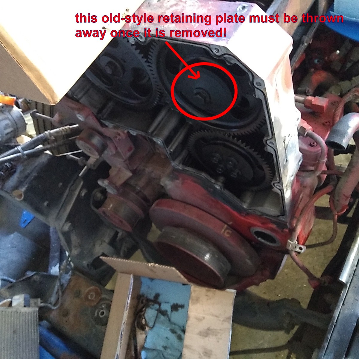

RE: CM871 kickin my Butt (07-27-2020 )RustyWood Wrote: Well here I am still waiting, (weeks now) for my Cam Wedges and Crank Pin to get here. According to procedure I must have them in place and they must remain in place before removing Cam Gears to get my Head off. First of all, I don't see any scissor gears. The pic shows you only have straight gears. There is nothing to worry about with that. NEXT:... ![]() you have the old style cam gear retaining plate. Those were prone to failure and yours should be thrown away once it is removed, and replaced with the flat (newer) style. Otherwise, you are risking a gear train failure. ref: http://rawze.com/forums/showthread.php?t...9#pid23329 ALSO: it looks like you have removed all the rockers and rocker shafts. There is nothing stopping you from removing the 2 top gears (for the overhead cams) and the cams, and then the head. -- you only need the wedge kit to re-assemble the engine, not to take it apart. BTW: here is a wedge kit + gear puller... Looks like this one would work just fine: https://amzn.to/2X2HAmE User's Signature: ->: What I post is just my own thoughts and Opinions! --- I AM Full Of S__T!. | |||
