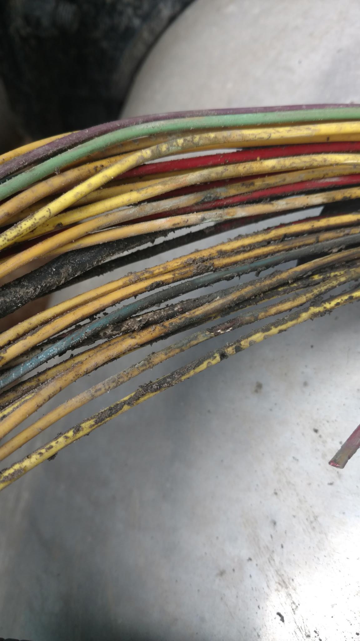

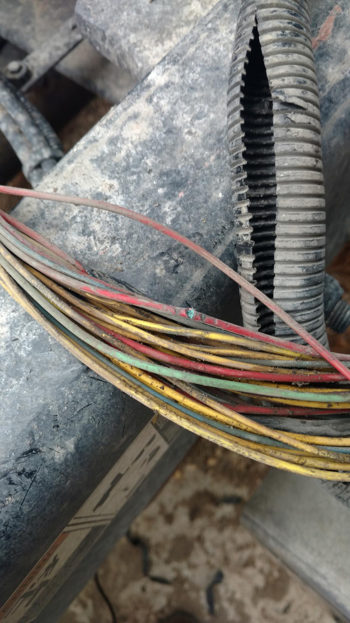

| RE: 2015 T660. Reverse lights I found my trucks troubles. Wires going to chassis node had rubbed thru their insulation and corrosion had set in. . I blame it on dirt getting inside the wire look and grinding on the insulation of the wires. Everything seems to be working as it should now. I didn't have a wiring diagram, just started checking wires. Looked like a likely area for something to go wrong seeing as how they have the wiring making some really tight bends. User's Signature: 2015 Kenworth T660 | |||
