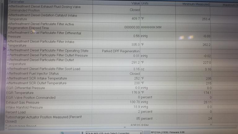

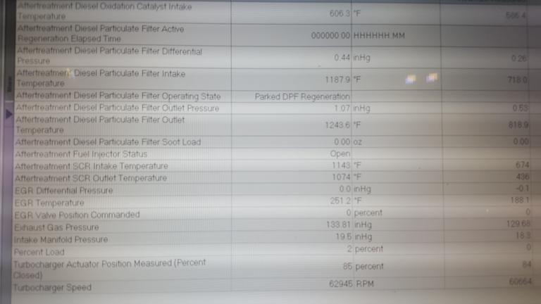

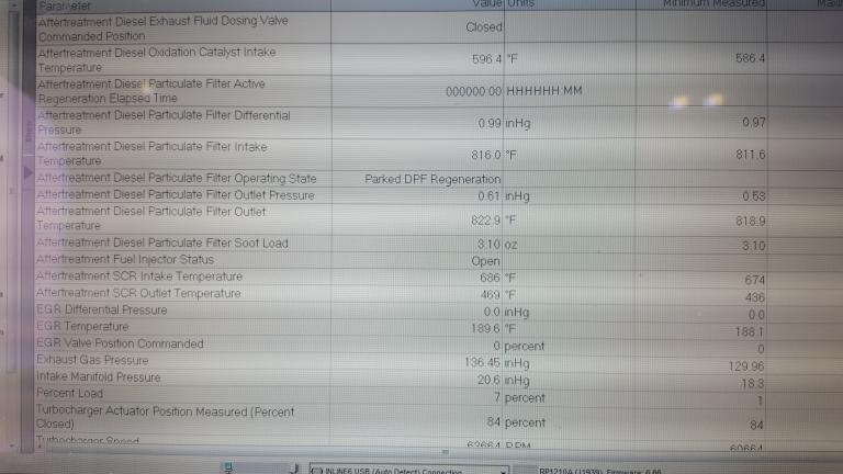

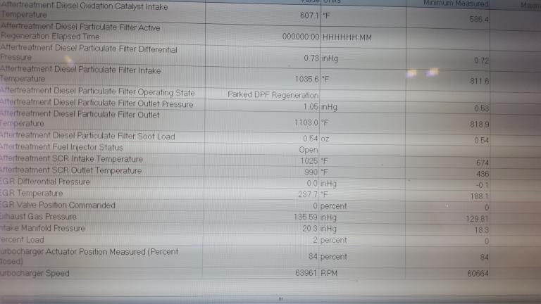

| RE: Diesel particulate trap 1 psi codes Do you guys see anything alarming with the aftertreatment history? 1274 and 1271 is pretty high temps, what normally causes this issue? Im going to do a forced regen and I will update with screen shots of regen First picture is start of Regen, then about 5-8 mins later another picture of what changed in that time frame ![]() ![]() ![]() Next pic is about 30 mins in ![]() 1 hour and 10 mins | |||
