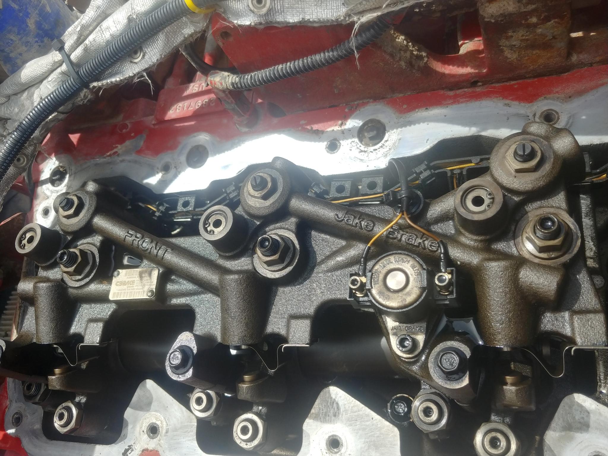

RE: Cm2250 overfueling intermittently (12-21-2018 )Tamip Wrote: https://youtu.be/iLe9BT4vrsMDifferent animal .....they do operate under the same principal but there are stages and the third stage uses your turbo and computations from ecm. this is my cm2250 jake head there are two of them (front and rear) you can see the selinoid, two wires, to test you check ohms on them. you can pull them out and there is a screen on orifice at bottom make sure its clean (screen kinda just pops off) | |||
