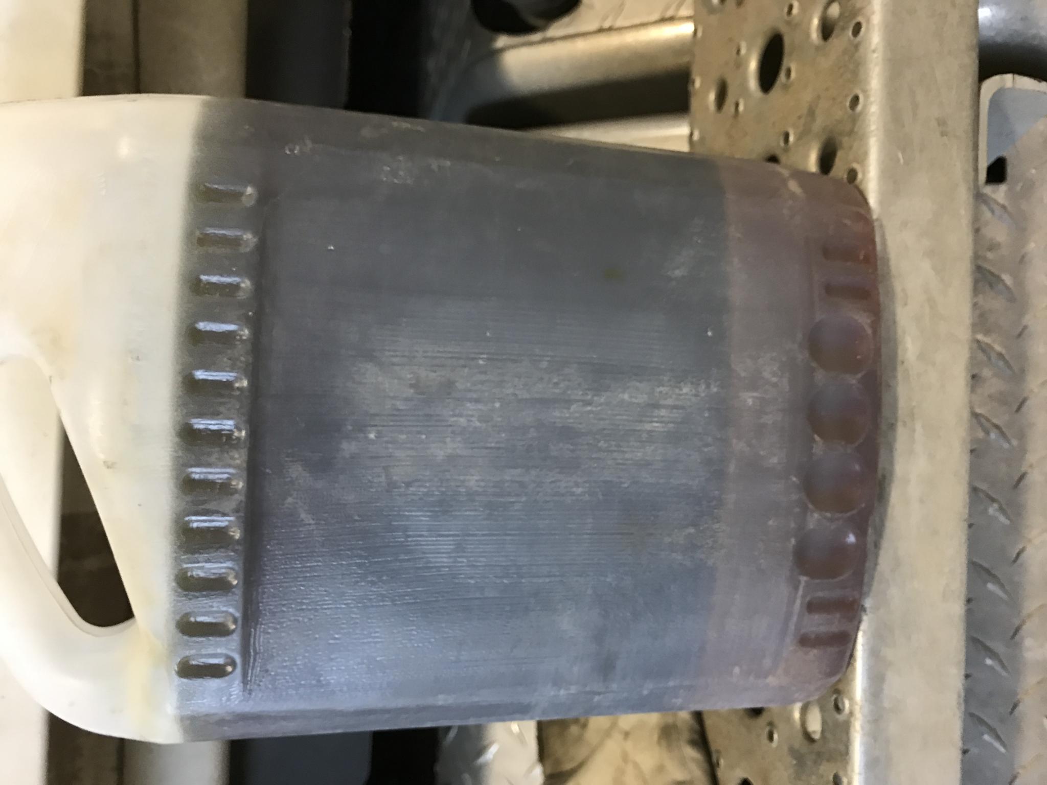

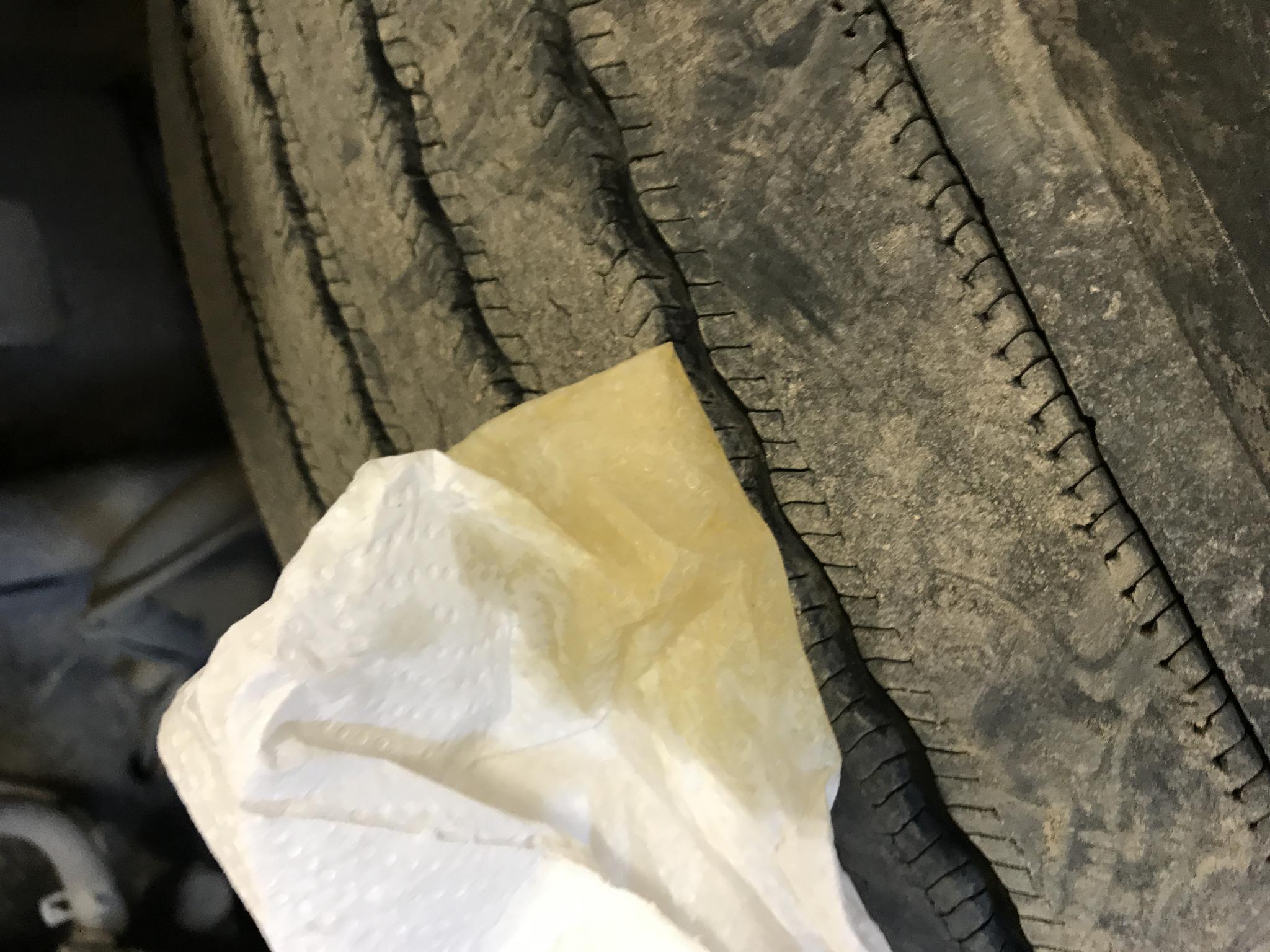

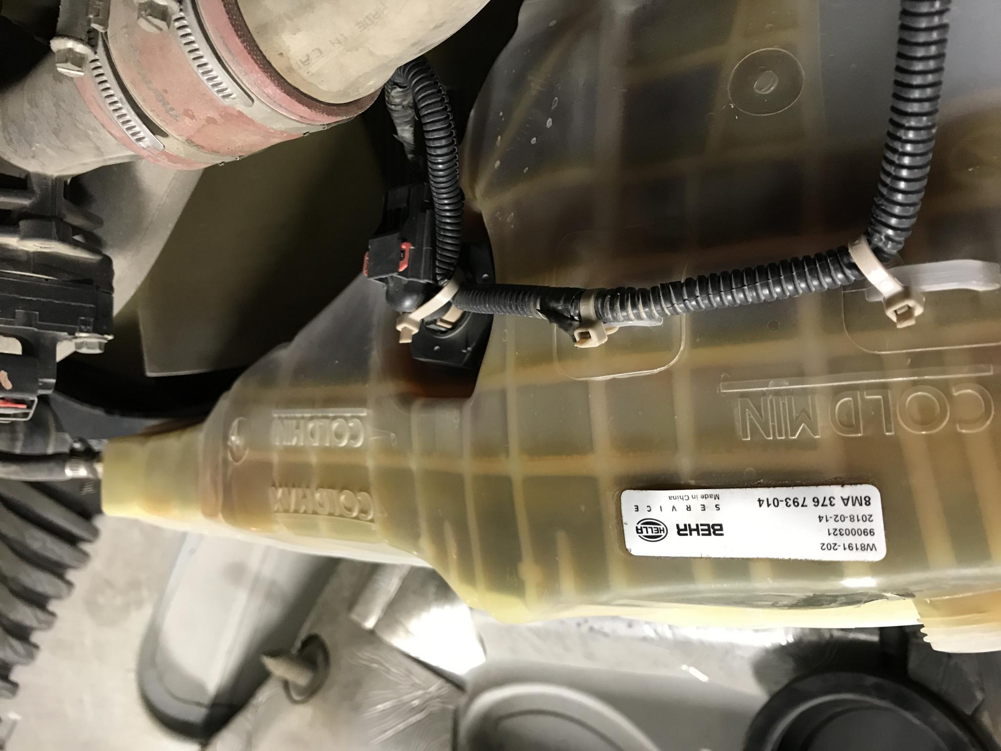

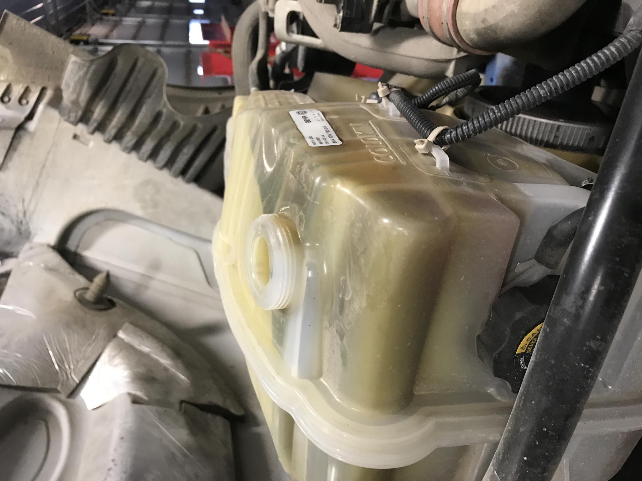

| RE: Slime In Coolant Detroit DD16 Well the problem finally showed up big time. Since the original post, I continued to get this slime on occasion. Yesterday I noticed a mild burnt oil / plastic smell. I looked around last night, no oil leaks, but the coolant level looked low in the reservoir. I went back this morning. Looked like the coolant was down just under the lower line on tank. I spun off the filler cap and saw the tank was completely full of diesel fuel sitting on top of the coolant. I siphoned off a gallon in the jug, coolant is bottom two inches. Truck is now in for injector cups ... 393,000 kms (244,000 miles) | |||
