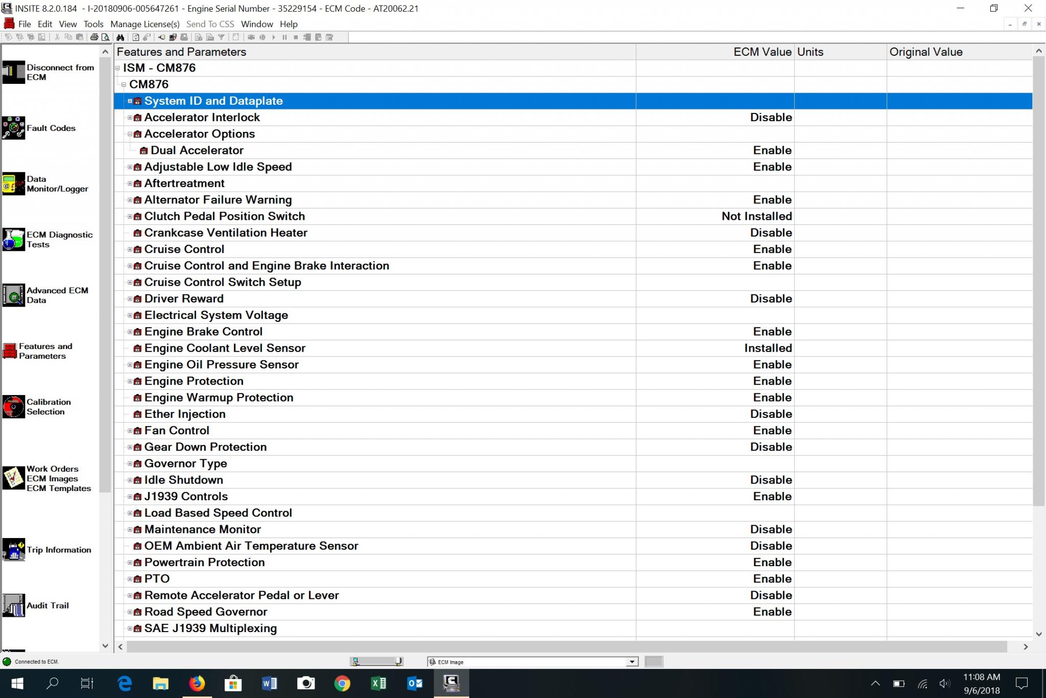

RE: 2008 ISM 500 CM876 issue (09-06-2018 )Nilao Wrote: Make sure the dataplate tab in insite matches your engine serial number and CPL that is listed on the valve cover dataplate. Look under the regeneration tab and see if it is disabled. There has to be regeneration history of it's got a dpf. I dont care if it's only got 3000 miles on it, it had to do s regeneration by now. Also make sure you do not have a remote pedal option selected under features and parameters tab in insite. I dont think RV'S have a remote throttle. Here is a picture for the features. Seems that remote pedal is disabled | |||
