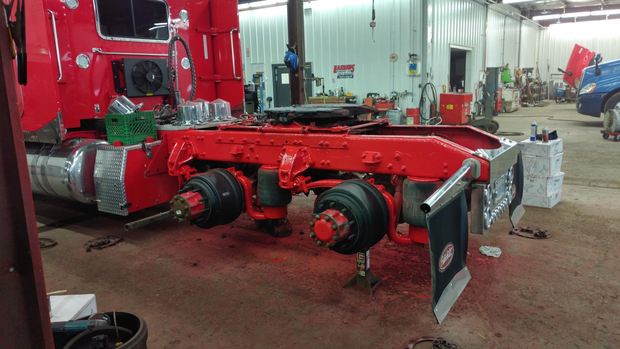

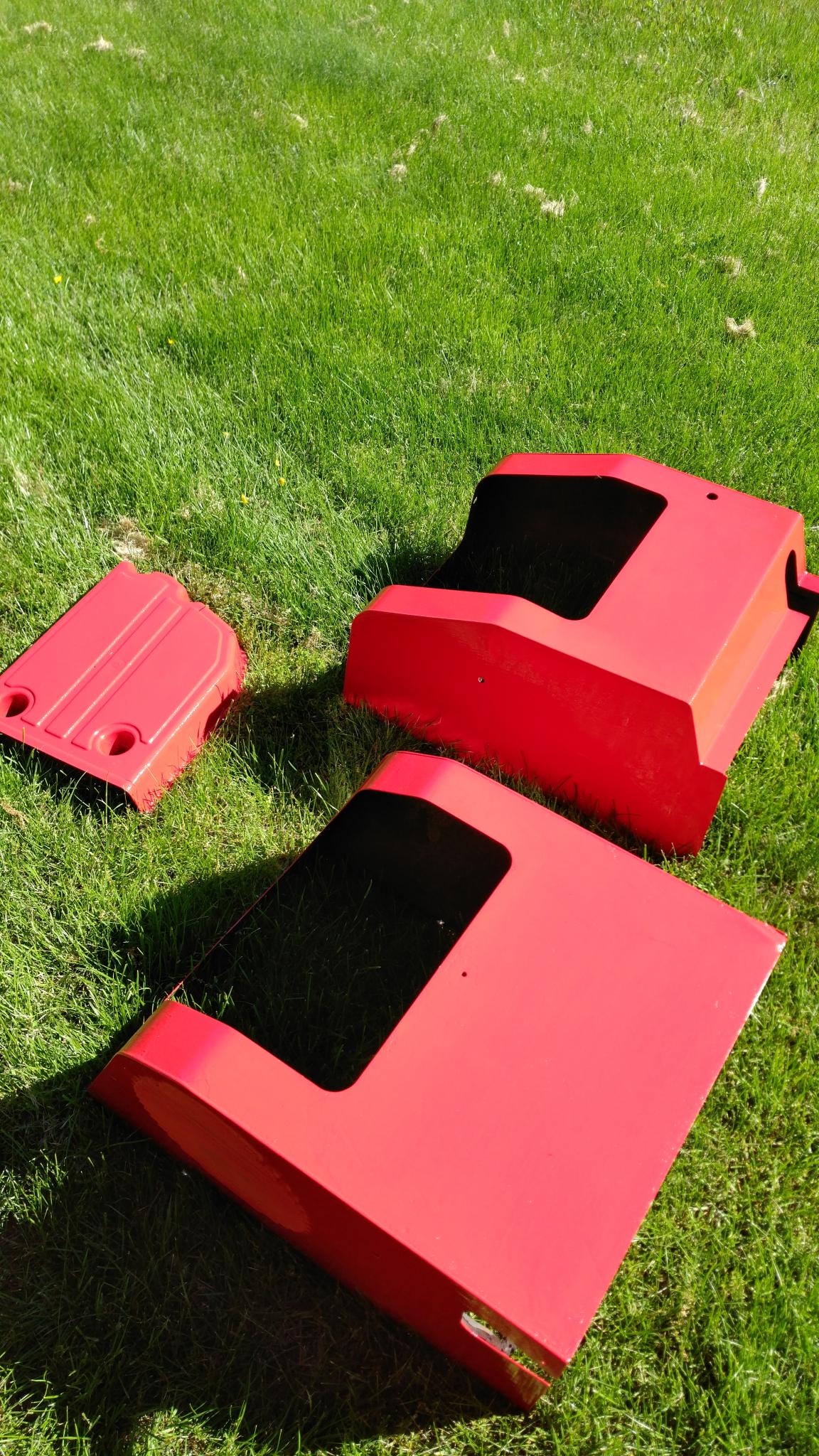

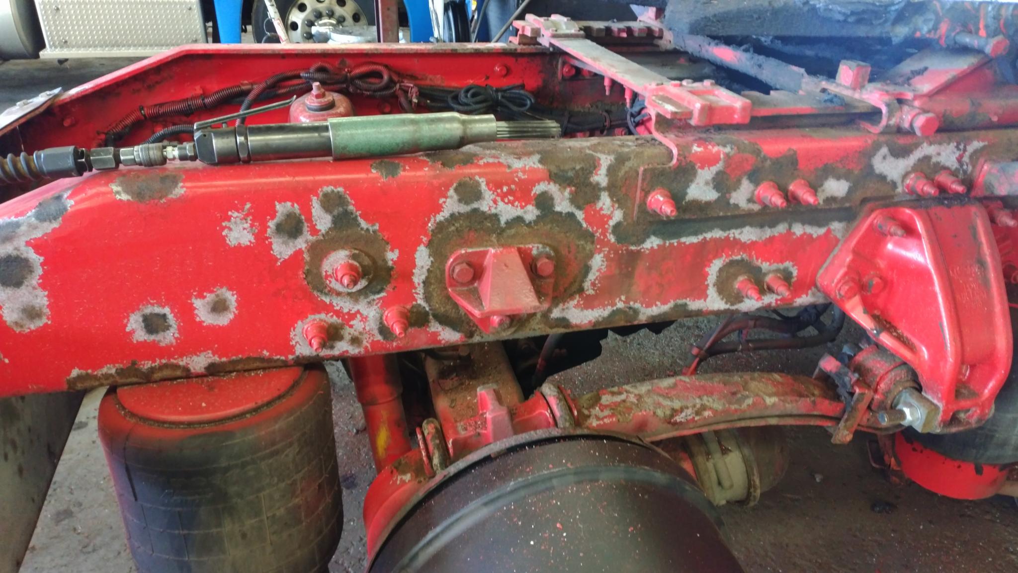

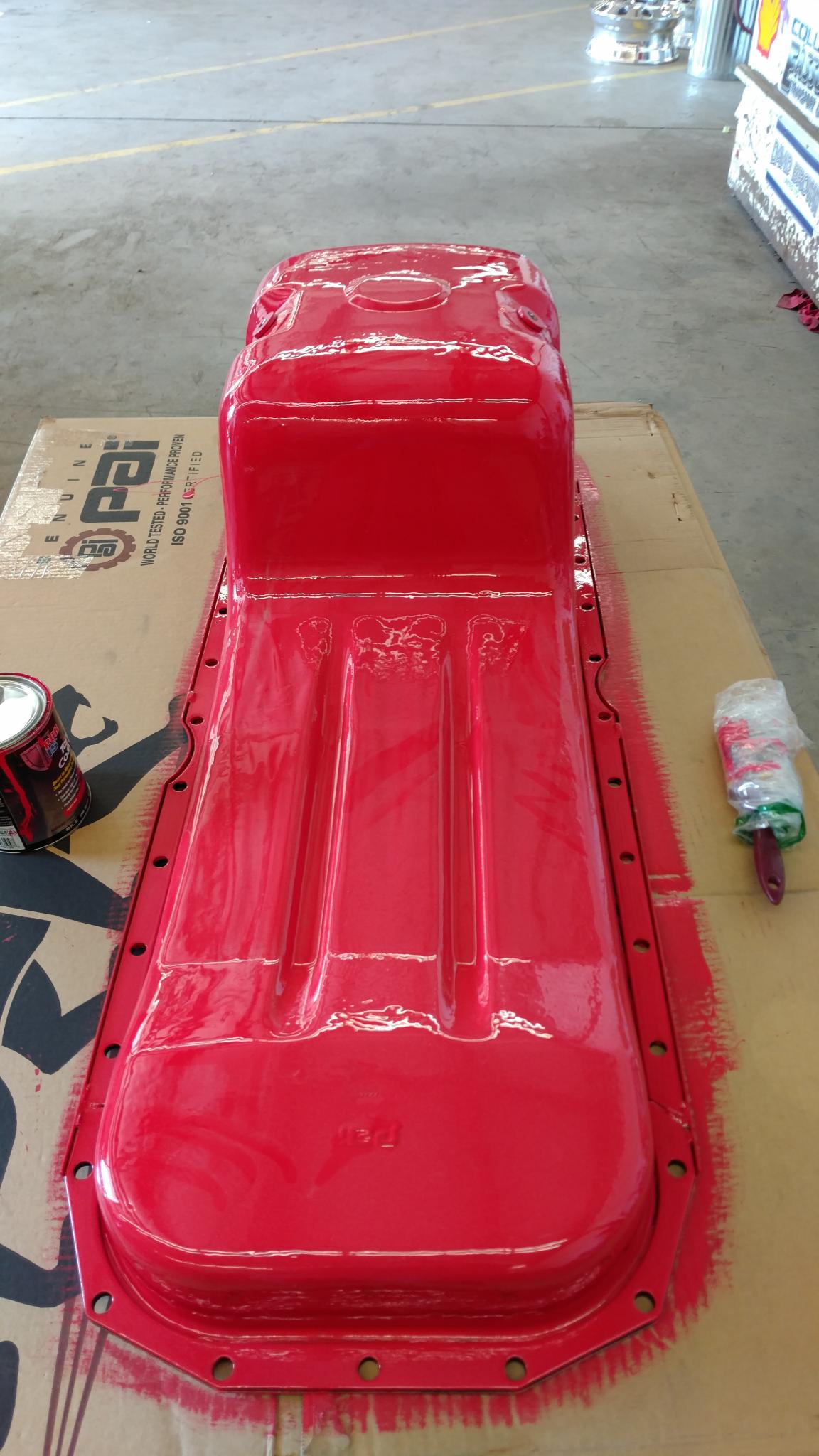

| RE: Crawling under the truck... Por-15 is kick ass. I needle scaled the back half of my frame when I had all my wheels off doing brakes.. best part with that stuff is you can apply with a brush and it dries smooth. I've only used the red top coat but it's thick and hardens right up. Buddy of mine has fiberglassed with the black stuff it hardens up so much lol. See how it fairs this winter, I applied it my new oil pan before I installed, APU cover and frame. Oil pan only lasted 2 years before it rotted and APU cover wasn't fairing to well after 1 winter. Eastern Canada winters is a good test for the stuff. Pictures attached were all done with a brush. Oil pan and APU turned out nice. Frame looks pretty good from about the distance the picture is taken, got a little carried away with the paint lol | |||
