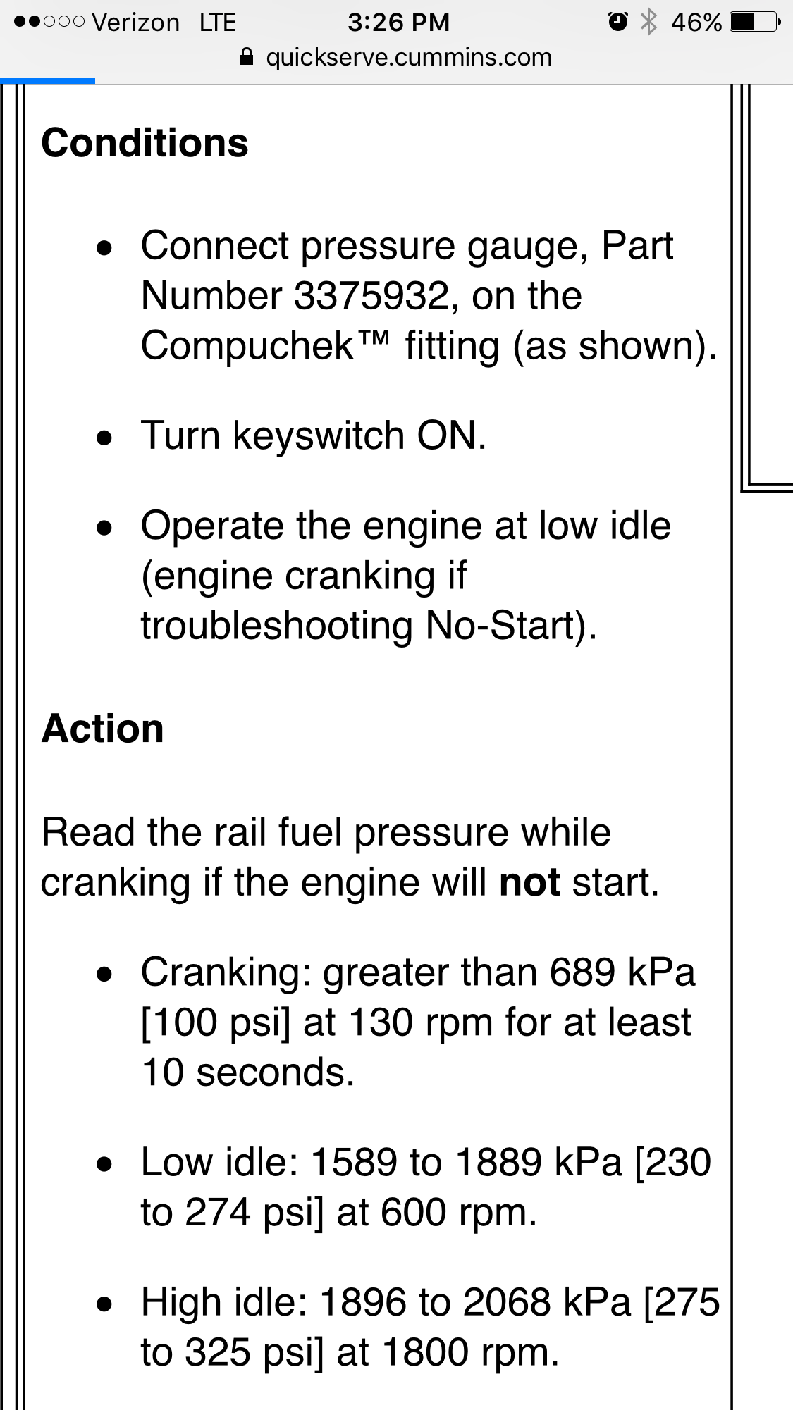

| RE: Air fuel control derate? As per Quickserve: 100psi at 130rpm while cranking for 10 seconds (no start condition check) 230-270psi at low idle 600rpm 275-325psi at high idle 1800rpm Insite will tell you the pressure of the fuel rail while connected. Remember, the proper way to test is a mechanical guage connected to the compucheck fitting, but insite is a valuable tool if you don't have a mechanical gauge available. ![]() Post #20 in this tread has my results, which IIRC are the same as mine were during my road testing. http://rawze.com/forums/showthread.php?tid=1365&page=4 User's Signature: Why? Why do I always ask "why?" Because I can't learn or help teach others with "'cause I said so..." | |||
