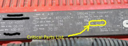

- To understand how they do it, one must understand a little more about the engine and its programming. The engine itself has a vast amount of adjustment range. This means that it is usually possible to increase or decrease the horsepower by quite a little bit without too many ill-effects. There are however limitations based on what hardware you actually have in your engine. To do it right, someone needs to know what hardware you actually have AND what make/model vehicle. The "engine" part can be determined easily enough by looking at your engine cover data-plate. Here is a picture of one...
./uploads/201602/post_1744_1455828655_db8b9793b6966dd4c84e74f2cd76b683.jpg
- The CPL number, or Critical Parts List, is the number that is used to identify the actual hardware inside the engine itself. Things like the injectors, cam, etc. This number is also what the most shops use to determine what power settings, or so called 'Calibrations' that can be put into the engine.
There is actually no 'Horse Power' adjustments that can be made for ISX engines on the fly using the Insite/dealer software. HP is basically set in stone from within a varying list of different files, referred to as Cals (Calibrations). These Cals contain a sea of parameters, upwards of roughly 7,800+ for the CM871 engine, and 12,000+ settings for CM2250's. The problem lies in that the CPL information is ONLY FOR THE INSIDES OF THE ENGINE ITSELF and not the rest of the vehicle. It is only half the picture at best, looking at those files and their descriptions. Little or no information is provided for what make and model truck, transmission, CAC unit, turbocharger, or other external components that greatly effect the engines operation is listed.
The intake, exhaust, and other components in different model trucks effects how the engine runs and therefore there are sometimes very different programs for the same exact engine hardware. Because of this, there will sometimes be several different cals with the same cpl listing that are actually NOT compatible for the vehicle. Because of this, you can easily get some problems like mentioned above.

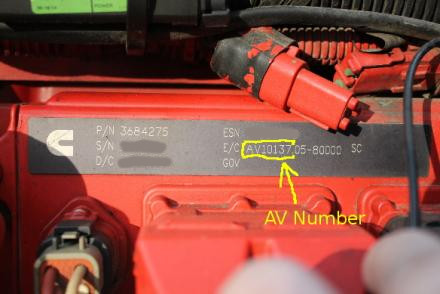

-- The correct Calibration (software) for your engine is actually stamped on the ECM, and is listed as an E/C code. On the CM871 enignes the AV number is the software that is supposed to be in your engine when it was built. -- It can be found here...
./uploads/201602/post_1744_1455828744_c0c49052d58ff94fbc45648c6e767ef8.jpg
- The AV number, on a CM871 (other model engines use different prefixes like BN for example for the CM2250) is a number representing the exact software that matches YOUR ENTIRE TRUCK!, not just the engine itself. This is what was put in by cummins, when the engine was built, for that specific model truck and year. It contains the correct settings for the specific type of DPF, and all the other things that your particular truck was built to run on. It also has all the unique torque settings to match your clutch, transmission, drive-line, and rear end components. That number is the name of the 'Cal file' that originally belongs to your truck, and the only way to know for sure that you will not have DPF, regen, or other problems, is to ensure your ECM is running that same file, or its equivelent file (usually a very high number) for an Updated component like the Updated (newer) DPF's that are out now. -- Of course, if the ECM itself is not the origonal, then someone can always log onto 'Cummins Quickserv' and look up the correct file, using your Engine serial Number (ESN Number).
At the end of the day, if your having EGR and DPF problems, and/or repeating other issues with your After-treatment system, (sensors reading wrong, etc.), then at the very least,... Ensure without doubt, that you are running the original AV number that your truck was meant to have, at least until you solve all your problems, and it is running reliably again. I cannot count how many times I have helped truck owners fix, once in for all, their truck problems, by simply putting their truck software back to its original Calibration, many of which, never knew it had been altered.
- To check what AV number you have, you need cummins Insite. Just open the 'Features and Parameters' section, and look under 'Calibration Information' area at the ECM Code. It will have your AV number with a decimal point, and some more digits, for example an AV10223.06 would be an AV10223 Cal file. The ending number 0f .06 is simply the current 'Update', so the higher the number after the decimal point, the newer the file is. An ending number of .09, for example, would be a newer version of the correct file. My own truck has an AV10064 cal in it, and is made specifically for my prostar.
