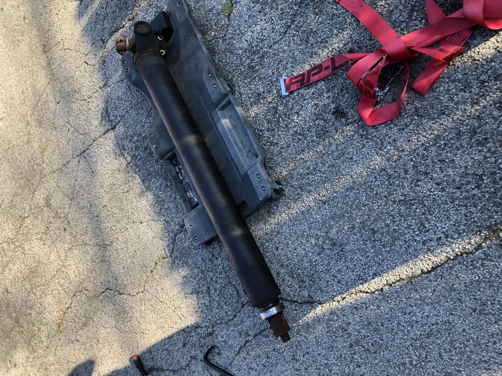

| RE: Busy busy busy! So here is the picture of what the carrier bearing looked like, the old one. The new one went on surprisingly with little effort. That was a learning experience! But a good one at that. I had help tho from a couple of Volvo mechanics, tho muscling it around on and off wasn’t fun. Especially the other drive shaft was a and is a SOB to take on and off. Will do that job some this month or next month. User's Signature: The creator said " Help your self and I will help you; Protect your self and I will protect you " | |||

RE: Busy busy busy! (08-12-2020 )Evotrucker Wrote: The new one went on surprisingly with little effort. Hmmm, I don't know if this is good thing. Hopefully someone will correct me if I'm wrong but all the carrier bearings I've replaced have been pressed off and on. I'd be afraid of the shaft spinning in the bearing if this happened. Everything you've gone through with that truck reinforces why I will never own a Volvo. A non serviceable axle with wearable parts... sounds like Volvo engineering. I found a Hendrickson replacement with serviceable ends but its more expensive. | |||

RE: Busy busy busy! (08-12-2020 )Chamberpains Wrote:(08-12-2020 )Evotrucker Wrote: The new one went on surprisingly with little effort. Oh the axle can be serviced, it’s got nipples on em. You just can change out the king pins like a normal axle or like every other one. The parts guy at Volvo was skeptical at first also, he didn’t know that volvo made em that way. The newer updated volvo parts has come a long way! It’s just my truck never got the special treatment lol. Until I came along :p. The aftermarket is where volvo is where it’s not strong at..... my friends who own the other manufacturers don’t have much trouble finding parts on the aftermarket seen. Volvo not so much lol. User's Signature: The creator said " Help your self and I will help you; Protect your self and I will protect you " | |||

RE: Busy busy busy! (08-12-2020 )Chamberpains Wrote:I've seen people change carrier bearings before and it's always a lot of heating and pounding. I just replaced my front carrier bearing last week. I pulled the front shaft and took it to a guy here that has a machine shop. Dropped it off and grabbed breakfast. Two hours later, new carrier bearing and front joint. He checked it and made sure it was still in balance and no other issues. I took it back and put it back in. Last time I did both carrier bearings and all six joints at the same time. That was May of 2018 and I took all four shafts to the machine shop, just easier and he checks them out. The front carrier bearing always goes out before the rear one. It holds up two full size shafts. I've changed out joints before but never attempted pounding off carrier bearings.(08-12-2020 )Evotrucker Wrote: The new one went on surprisingly with little effort. | |||
