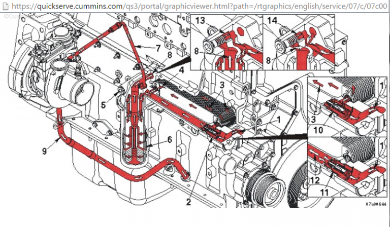

(03-08-2016 )yamajason Wrote:  What I am planning here is a pre-oiler that works for the 5 seconds you turn the Ignition key to ON while waiting for the glow plugs to warm up oil is flowing. I want 2 million miles out of my next camshaft. Wiring is the easy part here, plumbing is the challenge. I am going to get an oil cooler by itself to play with and remove port plugs, blow air thru it, and map out these ports for all to know. Wish I could get a CAD drawing of the oil cooler that shows internal views of parts
Don't forget an inline oil filter on your system! Sucking oil out of the pan and pumping it through the motor, Bad Idea. I'm sure you already thought of this. I'm just trying to promote my Duck Wing Pre-Oiler as it is far superior in this respect.
Hand Pumping a little oil, while checking your oil, would only take 4 seconds.
I have seen a diagram on Quickserve of the Lube Oil routing. It was for a CM2250. You might look there.

CM 2250 Lube System
