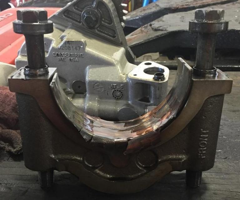

Crankshaft vibration is damaging to the crank bearings at the very least. Here is an extreme example of one that was the result of typical bad ECM delete programming. It was from one of those big-name places that advertises heavily, is expensive, and promotes themselves at all the truck shows.
It was one of those places that offer after-market non-vg turbocharger retrofits, and all kinds of other engine damaging/wasteful modifications. This pic is of one of the crank bearings after a couple hundred thousand miles of a bad program. It failed, throwing a piston through the side of the block (wrist pin failure) with no warning.

Does not matter WHAT is causing it -- If it is vibration due to too low of final crank angles, and/or moderate, and you are driving it -- Eventually your crank bearings will get excess play in them by being hammered on, and you will eventually destroy the engine by sending a piston through the block with zero warning. Regular inspection of crank shaft bearings is required, and you should be able to see differences in wear patterns on them to help determine where the vibration is coming from if it is cylinder/piston rod related.
