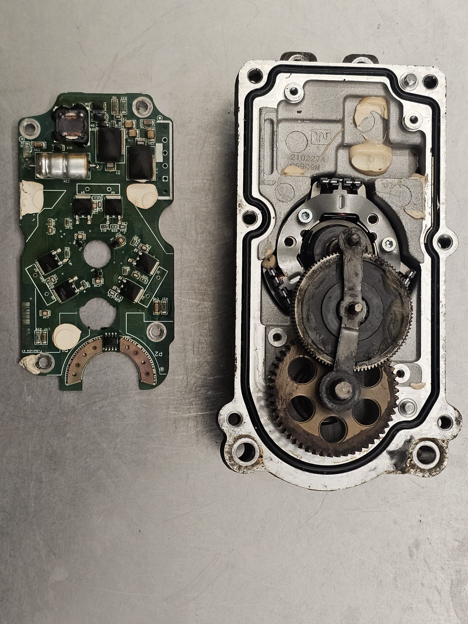

| MX13 turbo actuator issues Got one MX13 with 175 000 miles. It started throwing VTG turbo actuator Power Supply Internal error, VTG Turbochager Actuator Internal error and VTG turbocharger Actuator Software verification incorrect. Actuator is controlled by can bus (pinout is when start to count from plug from straight side of actuator - 24v, canH, canL, gnd). I checked for power to actuator, it is getting good 24v tested using 24v light bulb, ground at plug is also good. Can lines show 2.7v for high and 2.3v for low, powered off have good 120 ohms between the pair. So all points to the actuator. Decided to take it apart before ordering new one to see if there is apparent fault visible. At first only issue seems to be dry grease, I tried to turn gear on actuator and it did not move at all in one way. Played with it more and sometimes starts to move depending how I turn those gears that are loose, since other part of housing is needed there for those to not jump over. Therefore I decided to take out the board to get to the rotor bearing. Was not good idea, since the board is mounted to housing with what seems to be thermally heat conductive glue/rtv (or maybe it is used more for reducing vibrations to prolong the life of that circuit board) AND one inductor was so well glued that I could not remove the board without causing any damage. Going to look up inductor, new glue/rtv for attaching back the actuator and also bearings. If bearings are obscure and impossible to get I will clean them and regrease them, all issues seem to be caused by dried up grease. Maybe I am wrong and the issue is instead in the electrics - there appears to be three phase motor that is controlled by mosfets, maybe some of those is faulty instead. ![]() | |||

RE: MX13 turbo actuator issues (11-18-2025 )mikkhh Wrote: ...- there appears to be three phase motor that is controlled by mosfets, maybe some of those is faulty instead. looks like one of the flaky, crappy designs where the motor is not even soldered to the board. User's Signature: ->: What I post is just my own thoughts and Opinions! --- I AM Full Of S__T!. | |||

| RE: MX13 turbo actuator issues Searching around visually X15 turbo actuator looks the same. I looked at the board and inductor wires came off from solder, they did not break on one side. | |||

| RE: MX13 turbo actuator issues Got call, second same year similar mileage truck has same fault codes. Looks like it has to do with the first cold and snow around here. Will test out how actuator repair (regrease, old grease was dried up) went on first one, if calibrates succesfully will pull apart second one. Actually those look like can be regreased on truck without needing to remove coolant at all, only the board is finicky to remove from those press pins and glue/rtv. | |||

RE: MX13 turbo actuator issues (11-20-2025 )mikkhh Wrote: Got call, second same year similar mileage truck has same fault codes. Looks like it has to do with the first cold and snow around here. Ever since Holset (cummins) switched to that horrible, no-bearings, Teflon bushing crap, no-solder actuator design of those boards, they have been flaky as all h#ell, especially with cold/hot weather changes. To me, it looks like some idiot college intern clueless idiot designed that garbage board and setup, and it has no place in an industrial setting. I also mentioned this briefly back in 2020... here is that post... https://rawze.com/forums/showthread.php?...9#pid52979 User's Signature: ->: What I post is just my own thoughts and Opinions! --- I AM Full Of S__T!. | |||

| RE: MX13 turbo actuator issues Did some digging with the truck history - the factory original turbo actuator was replaced at 14 800 miles, at 15 000 miles the DPF was replaced under warranty too. My repaired actuator lasted 7.5 months until the ECM on that same truck died at around 190 000 miles. ECM I fixed but need to flash ecm to get out of max derate. The problem is in the board itself. I did improve those press fit connectors by soldering them, but main plug is still messed up no proper way to solder that, I just bent pins way wider and hope the best. | |||
